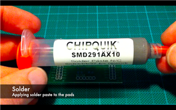

The first step was to clean the PCB. i used some rubbing alcohol to get rid of greasy finger prints on the pads.

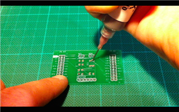

Solder
Next, I applied the solder paster to the pads. I had some difficulty getting the syringe to dispense solder at first, as I wasn't sure how hard I needed to push. Once I figured that out, I started to apply a little bit of solder onto every pad. The solder wouldn't stick on the first one, but after some fiddling, I managed to get it on there. Applying solder to the other pads went a lot easier.
I used Chip Quick SMD291AX10Chip Quick SMD291AX10 solder paste.

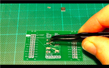

Components
With the solder applied to the pads, I started putting the components I had prepared where they belonged. I almost made a mistake with one of the capacitors, but realised it in time. Using a pair of tweezers I was able to easily put all components in place.

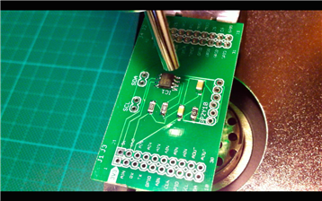

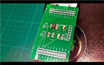

Reflow
Finally, using hot air (Tenma 21-10130Tenma 21-10130), I reflowed the solder and the components were soldered on. At first, the flow rate was too high and the components were being pushed away. After lowering the flow rate, things went better, but I still managed to get a resistor off the pads. I successfully managed to "push" it back on though image I'm thinking that I should have used a bigger nozzle.
Once all components were soldered in place, I powered off the rework station and pre-heater and let the board cool down.
