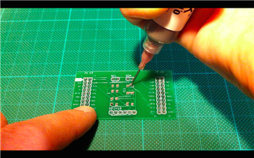

The first step was to clean the PCB. i used some rubbing alcohol to get rid of greasy finger prints on the pads.
Solder
Next, I applied the solder paster to the pads. I had some difficulty getting the syringe to dispense solder at first, as I wasn't sure how hard I needed to push. Once I figured that out, I started to apply a little bit of solder onto every pad. The solder wouldn't stick on the first one, but after some fiddling, I managed to get it on there. Applying solder to the other pads went a lot easier.
I used Chip Quick SMD291AX10Chip Quick SMD291AX10 solder paste.

    Quick question: Did you take the solder paste directly out of the fridge or let it come to room temperature first? I'm just curious why you had the trouble with the first pad.

  • fvan
    fvan over 11 years ago in reply to michaelwylie
    It was out of the fridge for a good 30 minutes I think.
    I'm thinking the first bits of paste to come out were a bit dryer, is that possible? When I added a bit more it suddenly stuck to the pad. For the other pads, I also held the needle vertically above the pads, which helped a lot as well.

    xever over 11 years ago in reply to fvan
    This is quite similar to how I do surface mounts.  Also, I always keep the paste inside the fridge all the time and only take it out as needed.  When applying it to the pad, I put my syringe at an angle about 30-45 degrees.  This is the brand of solder paste I used, CT-L63-S0515 - AIM PRODUCTS - SOLDER PASTE, 63/37, 183°C, 15G | element14 New Zealand, the fine tip is quite handy. image

  • xever
    either that or we are both completely off image with manual surface mounting.
    also, forgot to mention, I put the airflow about 50% and then bend the hose to have more control on the hot air.  and if there are any solder bridges, I use a flux pen and run the soldering iron through the pins/pads to get a cleaner.
