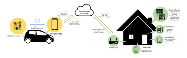

As with anything that is to be built, the blueprint for the system was first laid out, followed by foundation laying, then building the design closely to the initial plan but allowing for modifications and slight detours along the way.  This approach has always been the practice I've used in creating a working minimum viable product.  This approach will be discussed into a bit more detail in the next sections.
Architecture
During the first few weeks of the challenge and while waiting for the development kits to arrive, I started off thinking about the high level architecture which is simple and straightforward.  The image below depicts the high level architecture of the system.  Also, during this period, and since knowing the key components of the system, the software development environment were installed and configured.
From the high-level architecture, the features for each component were drafted and again another thought process about how to build a solution given the constraints of the challenge, i.e. must use provided kits and tools, limited time and budget, and the like.  For this process, pen and paper works best for me. image

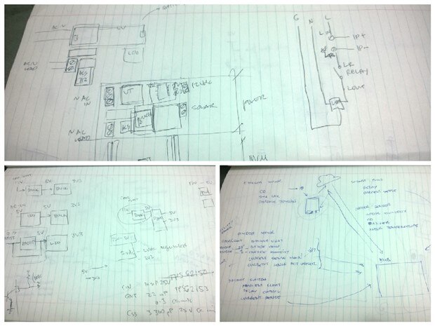

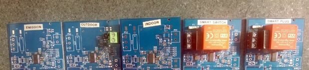

Hardware Design
Pen and paper design yields to some hardware blocks and from each block the key components are identified and checked if they would meet the requirements for the system.  Datasheets, application notes and reference schematic diagrams are used to draw the schematic and design the PCB.  While the waiting for the PCBs to be manufactured and delivered, the task was shifted into some software development.

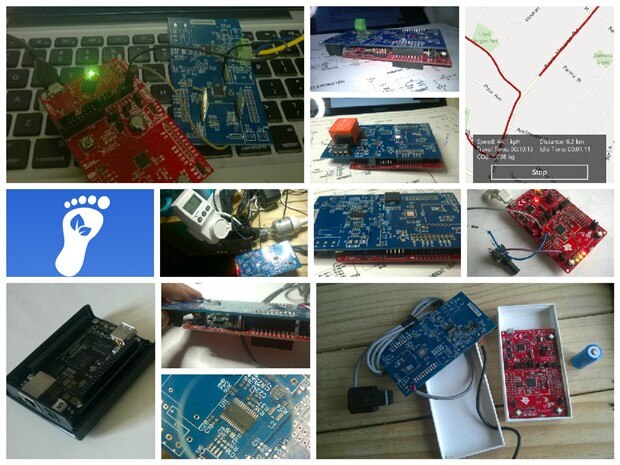

Results
I am quite happy with the outcome of this challenge.  With the limited time, I was able to build a basic yet functional prototype that would monitor my daily carbon footprint.  Knowing how much is the start for me to identify areas where I could reduce this footprint.  As an example on how to reduce the footprint, idling is a big waste of energy and is usually caused by heavy traffic.  Thus, it becomes more economical and more environmentally friendly to travel when traffic is light (already a known fact).  However, using historical data, we can create algorithms to "learn" and forecast when traffic is lighter in a given week.  i.e. Mondays always have heavy traffic from 7-9 but on Tuesdays through Thursdays, traffic is only heavy from 6:45 to 8:30.  We can then adjust our daily routines and be able avoid traffic on most days of the week.
Also, with the current data set recorded in the span of one week, I have few other ideas to make this even work better, i.e. base from the power usage data, it is possible to identify the activities inside the house at any given time.
Sierra Wireless' AirVantage is a big platform and I feel like I only scratched the surface and have not gone deep into its key features.
