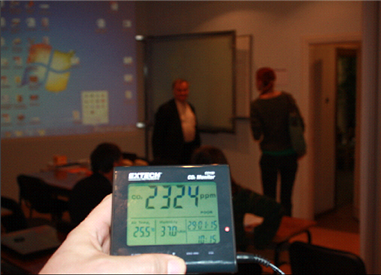

I have built a box that included many cheap sensors: temperature, humidity, light, sound, air pressure, dust sensor from Sharp and electrochemical CO2 sensor. It was assembled for test of air quality in school during classes and showed that it is important to open the window  during breaks. Probably graphing data is not so essential and it would be enough to just indicate with LEDs if air is good, normal or poor. Two school students wrote their scientific report in physics about air quality sensing and presented it at school. They got promoted to a regional contest.
CO2, infrared
Large part of roadtest budget was spent to acquire infrared CO2 detector. That is more precise than electrochemical. I interfaced it to the IoT and measured air quality at office and during meetings. As IoT provider I used Xively, the one that I had learned to use previously. AirVantage seems to be more complicated to get started with.
