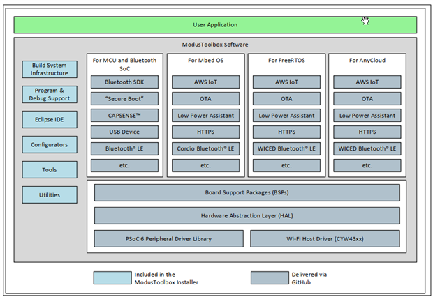

Here is a diagram with all the components included in the Modus Toolbox
Libraries and enablement software are available at the GitHub site

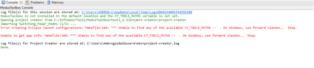

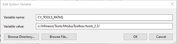

Setup process completes with no hassle.. However, after installation, I have been warned that a system variable (CY_TOOLS_PATH) was not set. In any case, I tried to build an example application and I got this error
So I simply opened Control Panel -> System ->  Advanced settings
Then I clicked "Environment Variables..."
Then "New..", and created a new system variable
With this change, the example applications compiles successfully

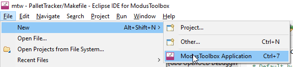

First of all, lets' create a new application application

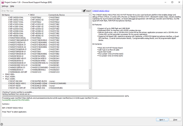

This will launch the Project Creator, which is a tool that allows you to select the correct BSP (depending on the board you are using) and a template application to start developing your project from
The kit provided for this challenge is the CY8CKIT-062S2-43012, so let's select the corresponding entry in the list

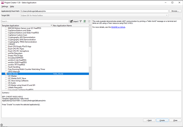

Click "Next" to proceed and choose a template application. I chose the "Hello world" template, which, according to the description, "demonstrates simple UART communication by printing a "Hello World" message on a terminal and blinks an LED using a Timer resource using PSoC 6 MCU."
Click "Create" and a new Hello_World application will be created in your current workspace

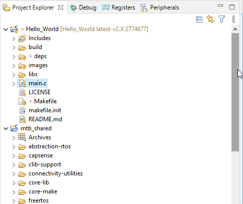

An supplemental folder (mtb_shared) has been created to store the libraries shared source code. This code will be shared by all the project you are going to created, thus reducing the disk usage. However, the Library manager (another tool of the Modus Toolbos suite) allows you to create a copy of the libraries that is private to a certain project

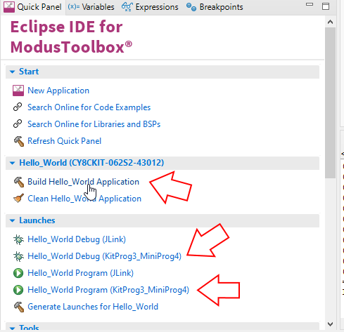

In the "Quick panel", you can now build, deploy the application to the evaluation kit and debug the code
Click "Build Hello_World Application" to create the binary file, then click "Hello_World Debug (KitProg3_MiniProg4)" to start a debug session or "Hello_World Program (KitProg3_MiniProg4)" to run the application with no debugger

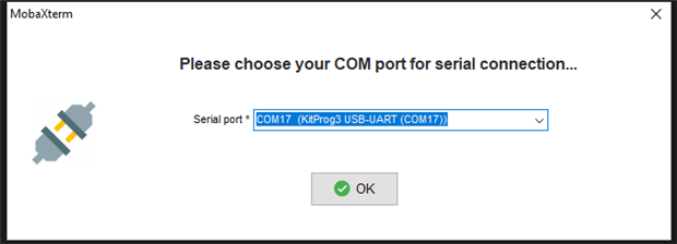

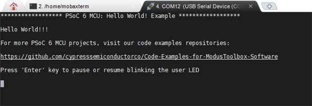

I opened a serial terminal, connected to the serial port corresponding to the PSoC6 board
and I got the following output
