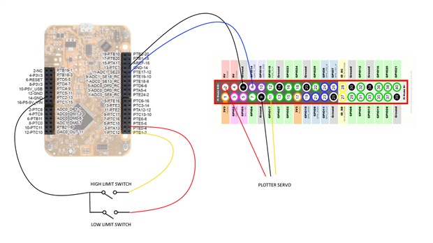

In this post, I will pack up everything I built and developed during this challenge. First of all, here is the wiring between the Freedom Board and the Raspberry Pi

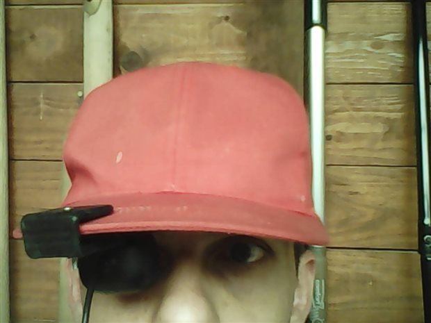

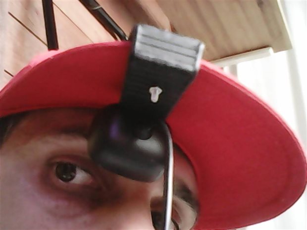

This is the webcam mounted on a baseball cap

The only disappointing thing is that the challenger's kit components had a very limited availability. This prevents me from completing the project. However, the eyetracker proved to be enough precise and not so difficult to get accustomed to. Strange to say, bu the webcam in front of your eyes is almost "invisible", in that it does not interfere with your sight. So, should the motor controller and the motor itself have been available on time, I'm quite confident I would have been able successfully complete this project
