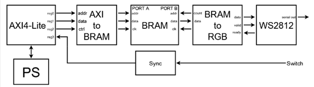

A MiniZed WS2812 Controller
While this project could easily have been done with a microcontroller, and often is, avnrdf decided to build one with the Minized, using both its PS and PL. Here's how it works: "The WS2812 RGB LED uses a single wire serial protocol that infers '1's and '0's by varying the width of a pulse. The project moves the serial output generation & refresh to the PL. The idea is that software in the PL simply writes 'data' to an 'address' in the BRAM (which corresponds to the RGB data of a LED of a given index), and the logic in the PL independently iterates through all the data in the BRAM using the other port, refreshing the LEDs. the main parts are the application that runs in the PS, the AXI4-Lite interface, a custom AXI to BRAM interface, dual port BRAM, a custom BRAM to RGB interface and a RGB to WS2812 generator. I could have used memory mapped BRAM using the Xilinx AXI-BRAM IP, but decided to build a custom interface that uses registers."
