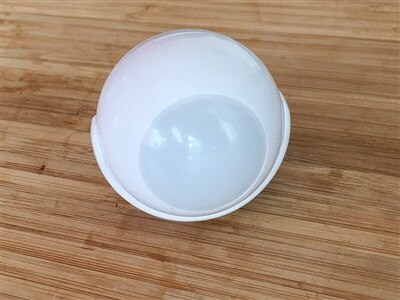

Light when and where you need it
90%
Sensors are placed in both the kitchen and the entrance room. The Core knows about them and as described in [Pi IoT] Thuis #8: Core v2: A Java EE application rules are defined to turn the lights in those rooms on and off depending on movement and time. This works pretty well already!
To-do:
  • Further optimize the rules
  • See if improvements can be made by using iBeacons

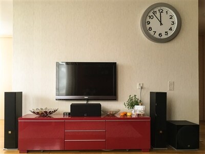

Home Cinema
90%
The Z-Wave hardware for the home cinema is in place (using a 6-socket PowerNode), so it can be turned on and off. Using the above mentioned Plex and CEC integration we can fully manage the home theatre system. An extra Raspberry Pi 1B was placed next to the TV to control devices through HDMI CEC. This is described in [Pi IoT] Thuis #15: Home Theater part 2: controls. The Ambilight will be finished at a later stage.
To-do:
  • Add and integrate a DIY ambilight

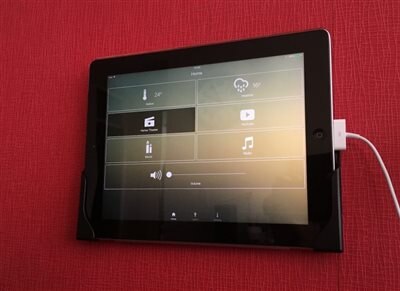

Mobile & On-The-Wall-UI
100%
The app is running and fully functional, as you can see in [Pi IoT] Thuis #11: Final implementation UI design, you can manage devices in the house and see the latest status. A wish is still to add a speech control to the iPad app. In the kitchen we have an iPad mounted on a cabinet as well, for which I would like to create a separate app with additional features like a cooking timer and a recipe browser (my girlfriend supports this idea a lot :). Another option is to use a Raspberry Pi plus display, which will be integrated in a cabinet door.
Todo:
  • Add speech commands
  • Create a custom app for the kitchen (either iPad or web)

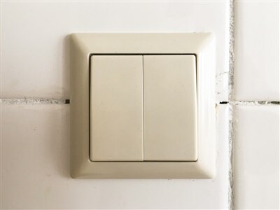

Manual override
80%
Most lights can already be switched manually using the buttons on the walls. Some of them should however be switched using the secondary button, which does a scene activation. I still have to add support for this to the Zway-MQTT.
To-do:
  • Add support for secondary buttons in Zway-MQTT
