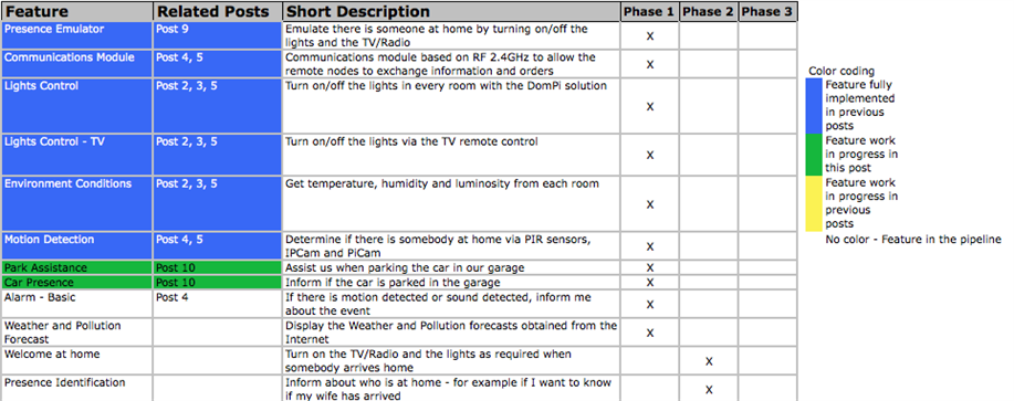

Project Status
Park Assistance
This feature consists of two new components to the DomPi: an ultrasonic sensor HC-SR04 and a 5" TFT LCD screen with the required shield to adapt it to the Arduino Mega. Let´s have a view at both components and its usage in the project.

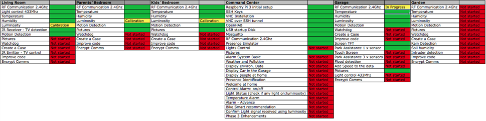

Current Situation of the Garage node
I´m currently facing issues with the TFT and the RF24 modules for the communication with the Command Center. Both modules work fine when only one is connected, but the RF24 stops working when are wired. The reason for this malfunction seems to be on the SPI. Both modules use the SPI bus to connect to the Arduino, this bus supports multiple devices connected to it with a protocol that governs who and when can access the bus data. From what I am seeing, I believe that the TFT does not fully comply with the SPI specification and does not release the bus... Since I prefer to invest time somewhere else in the DomPi project, I have decided to split the Garage node functions into two, the slave and the master.
Tasks split between slave and master:
  • Slave: temperature, humidity, luminosity, movement, distance measurement, TFT display and I2C slave node
  • Master: 2.4Ghz radio frequency communications and I2C master node
Due to this last minute SPI conflict, I will defer the code and the Garage node finalization to an additional post, hopefully later this week!
