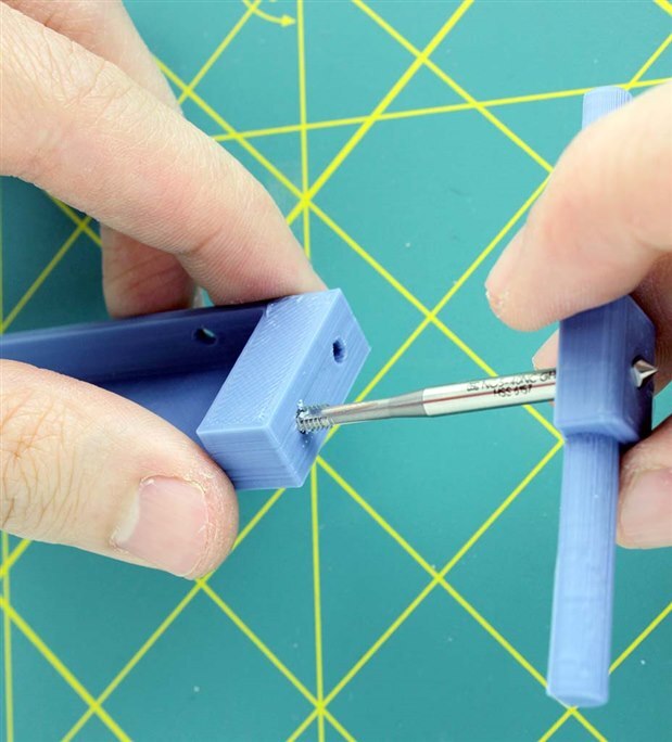

It didn't make much sense to me to incorporate snap-fit features to the general assembly since the overall structure will have to support the weight of the RPi + Touchscreen mainly. Also I would most likely be assembling/disassembling several times the project while it evolves. With all of the above in mind, it made sense to add holes for screws to the project -which require to be tapped as threads that small are hard to replicate in a 3d printed part. Below the list of screws I will be using to assemble the project:
  • 2 x #2 x 3/8" Slotted Round Head Screws
  • 6 x #5-40 x 3/8" Socket Head Cap Screws
  • 2 x #6-32 x 2" Socket Head Cap Screws

Hologram Pi-ramid: Tapping #5-40 holes with a 3d printed tap wrench
Hologram Pi-ramid: Tapped holes #5-40

    Solid looking work there. I see that you are using 15% infill, do you have any issues when it comes to tapping the threads? Good luck on your future developments on this design challenge. Gene

    Hello Gene, thank you for your kind comments!. I don’t have any issues when tapping the holes as I include them in the design with the right size (diameter and depth). They will have enough material to be removed when tapping -the amount of material should be the wall thickness which is 0.8mm in my current settings.
    if you look closely at the second picture of the assembly, the part on the left is tapped but the one on the right isn’t.
    Hope this answers your question.
