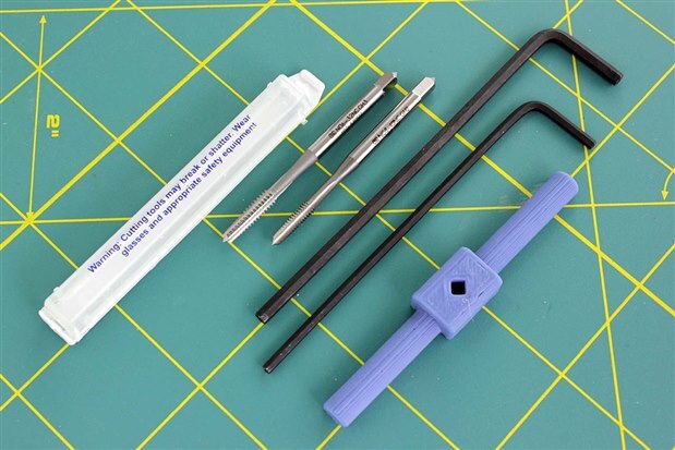

Once I was happy with all necessary the details in my project design, I started 3d-printing all the parts required to begin testing the assembly which overall is looking really good!.
3-D Print settings
Below the settings used:
  • Printer: Creality CR-10S -a big thanks to Element14 for this awesome price!
  • Material: PLA Blue-denim
  • Infill: 15%, triangles
  • Adhesion: Brim
  • Supports: No
  • Layer height: 0.2mm
Assembly and materials required
It didn't make much sense to me to incorporate snap-fit features to the general assembly since the overall structure will have to support the weight of the RPi + Touchscreen mainly. Also I would most likely be assembling/disassembling several times the project while it evolves. With all of the above in mind, it made sense to add holes for screws to the project -which require to be tapped as threads that small are hard to replicate in a 3d printed part. Below the list of screws I will be using to assemble the project:
  • 2 x #2 x 3/8" Slotted Round Head Screws
  • 6 x #5-40 x 3/8" Socket Head Cap Screws
  • 2 x #6-32 x 2" Socket Head Cap Screws
{gallery:width=960,height=768,autoplay=false} Hologram Pi-ramid - Initial assembly
Hologram Pi-ramid hardware: #2 x 3/8" and #6-32 x 2" screws
Hologram Pi-ramid hardware: #5-40 x 3/8" screws
Hologram Pi-ramid: Some tools needed for the 3d printed parts assembly
Hologram Pi-ramid: Tapping #5-40 holes with a 3d printed tap wrench
Hologram Pi-ramid: Tapped holes #5-40

    genebren over 7 years ago +4
    Solid looking work there. I see that you are using 15% infill, do you have any issues when it comes to tapping the threads? Good luck on your future developments on this design challenge. Gene
  • luislabmo
    luislabmo over 7 years ago in reply to dubbie +4
    Hello Dubbie, I think 85% infill is high as a default/for average parts, usually you will need something around 15% to 20% just to give some internal volume to the parts and also to help features of the…
    balearicdynamics over 7 years ago in reply to luislabmo +4
    Hi, despite the fact that the shell thickness should be a multiple of the nozzle diameter - for an obvious reason - I use a higher thickness just for the parts that need some post-production like sanding…

    Hi Luis,
    Wow - that looks like a very accurately designed 3D model. Looking forward to seeing it come together.
    The 3D-printed tap holder is nice too : )

    luislabmo over 7 years ago in reply to shabaz
    Thank you Shabaz, I'm glad you liked it!. If you ever need one, it is shared on thingiverse. I have a metal one but to be honest I find the 3d printed one easier to handle for for very soft materials as it doesn't add significant weight mostly at the beginning.
