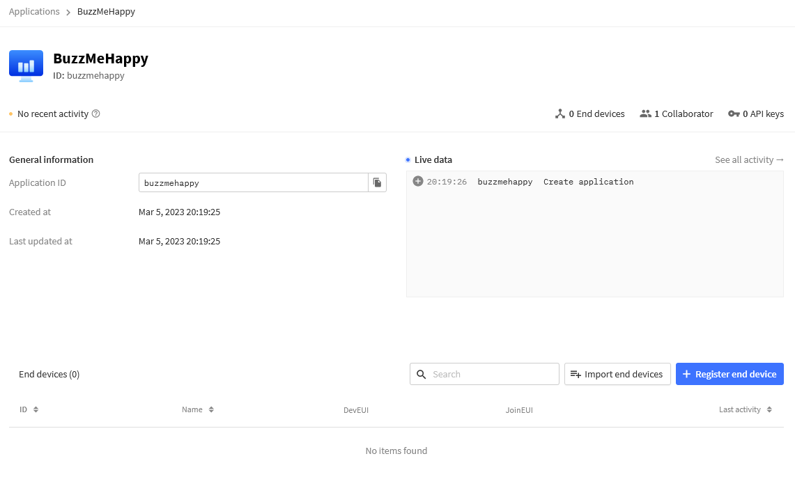

To start, we have to register an application on The Things Network.

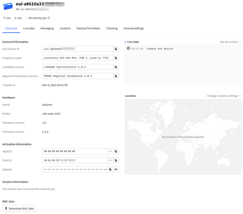

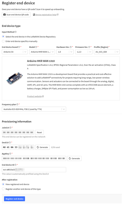

From there, we can add a device to the application.
Thankfully, there are some presets for the Arduino MKR WAN 1310 with 1.2.3 firmware. The correct frequency band-plan must be chosen – in Australia, this is FSB 2. The Join EUI can be set to all-zeroes, as long as it matches what you have in the arduino_secrets.h file. Then you will need to generate an App Key, to which you then paste into the file as well.
Then you should be led to the device status screen where there is a live update of the device status (if it has come online etc).
