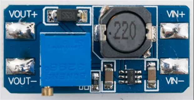

The first thought, of course, is to whack a boost module in there to step-up the voltage. However, which one in particular and where should it be connected? Ideally it should be something efficient and on-hand. It may be tempting to connect it to 3.3V and take advantage of the onboard PMIC to handle battery charging and over-discharge protections. Upon further thought, while that would work, it isn’t necessarily in good form as it could make the 3.3V rail noisy, stress the existing components and reduce efficiency as multiple conversion stages are being chained together. Instead, it would be much better to take the input directly from the unregulated battery for best efficiency.
In the end, I decided to use an MT3608-based step-up module that I had characterised back in this 2018 RoadTest Review. This one is known to be decently efficient, but most importantly, had a decently low quiescent current consumption. While I could just whack one in, I decided to do one better …
The 5V rail is not needed at all times - only when making a measurement. What if we could power-down the converter when it’s not in use and save on most of the quiescent current? That would stretch our battery lifetime (possibly significantly). I thought about how this could be done - if I added an N-MOSFET on the low-side, I could switch the input power, but the MKR’s 3.3V output wouldn’t make for a particularly low Rds (unfortunately).
Examining the datasheet shows that the MT3608 has an enable pin with a 1.8V threshold. This pin isn’t broken out in this module, so a quick bit of work with a knife to cut the trace between Vin+ and EN was enough to reclaim the pin, then soldering a jumper wire to the pin allows the converter to be controlled without the fuss of an external MOSFET. This may result in slightly higher leakage, but it is still better than paying quiescent current 24/7 for a 5V rail that isn’t needed all the time!

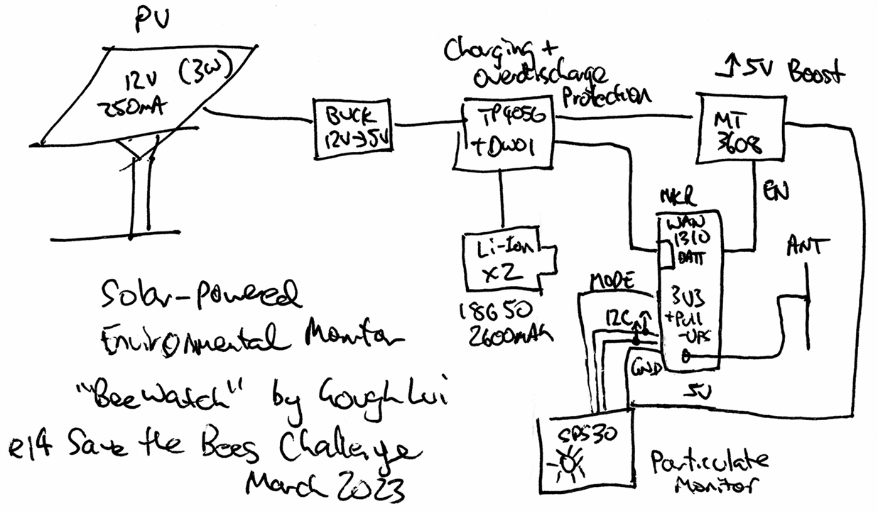

Just when you thought we couldn’t have any more voltages, we add solar power into the mix. Photovoltaic solar panels are a bit of an inconsistent beast - depending on the angle and intensity of the sun, the output voltage and current available, and hence the maximum power point changes. As a result, they don’t provide a stable source of power, but this is not necessarily too difficult to deal with. What is more important to realise is that modules are commonly made in “nominal” voltage ratings - 12V-system panels are common for smaller panels with a maximum voltage usually in the 16-19V range. Thus, we need to be able to handle this in some way.
Another issue now is that with the increased complexity and loads, there is a real danger of the battery becoming over-discharged over time, especially if something goes wrong with the power source and it remains unchecked for a while. In the other design, where every sensor is powered through the MKR board itself, there was no issue as the PMIC on the MKR WAN 1310 would cut-off the battery once it had reached its full discharge. In this one, we have a “dumb” voltage divider sipping current continuously, we have an MT3608 sipping its standby continuously as well, neither of which are switched by the PMIC on the MKR WAN 1310. Therefore, an external protection solution is needed.
Raiding my junk box again for cheap parts, a combination TP4056 single-cell lithium-ion battery charger seemingly configured for 1A with onboard DW01 and MOSFET for doing over-discharge protection. This is a rather “inefficient” linear charger, but sometimes we can afford this and the simplicity it brings. We will use this to arbitrate power from the battery to all loads and use it to charge the battery.
But wait - again, it is not as simple as plugging in a TP4056 to a solar panel since the TP4056 can only handle an absolute-maximum of 8V input (and that’s probably pushing it into overheat territory). Instead, this time, we need a buck converter to step down the solar input to about 5V for the TP4056.
For this, I chose a MP1584 buck module as I had some on-hand - these are also pretty efficient and inexpensive. Hooking up a solar panel to one of these directly is not necessarily a recipe for happiness - in fact, depending on the panel you have available and the weather, it may well “hiccup” as it starts up, gets overloaded by the charger, then shuts down. The good news is that through these “hiccups”, the battery is still receiving some charge. The downside is that such hiccup operation is going to keep resetting the charger chip thus over-time protections and proper termination may not function as desired. However, if you’re using “salvaged” lithium-ion cells like I am, then perhaps this is not so important. In theory, if you didn’t mind “floating” your Li-Ion cells (and you really shouldn’t), you could set the buck to a safe 4.0V and leave it hooked to the cell … but at the cost of potentially shortening cell life and added quiescent current. You’d still likely need a DW01 and MOSFET combo to keep the cells from being over-discharged in the worst-case scenario.
Coding a Sketch and Updating the Parser
The block diagram for the system I’ve described so far looks like this:
