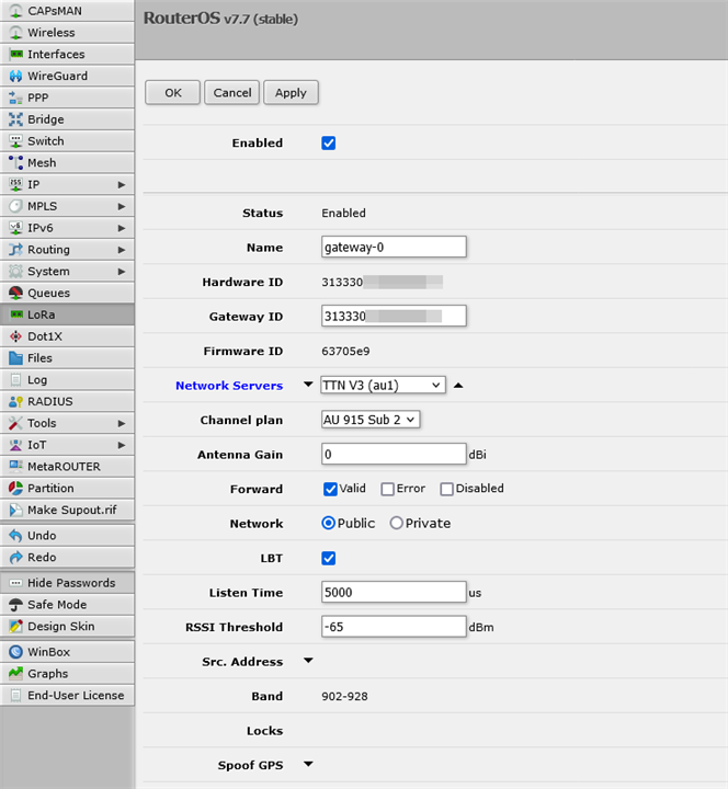

With the LoRa Module installed, we should first ensure the radio is disabled before configuring. In the configuration screen, you can read the Hardware ID which you will need for creating a gateway on The Things Network. In the meantime, configure the Network Servers to the one that matches your cluster selection and the Channel Plan to the one that matches your region. Set the antenna gain to the closest value to your antenna to ensure RSSIs are reported correctly (I did this later) and to forward only valid packets. Enabling Listen-Before-Talk (LBT) will help reduce the chances for collisions. Save the profile and do not enable the radio just yet.

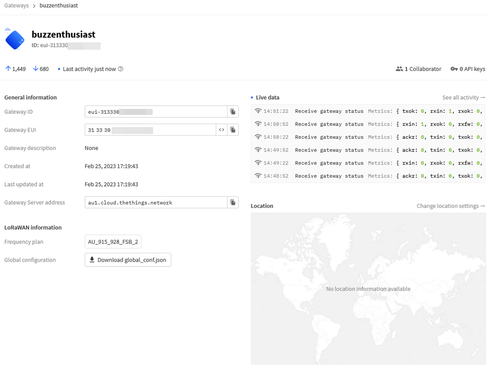

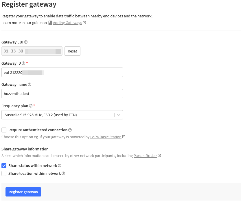

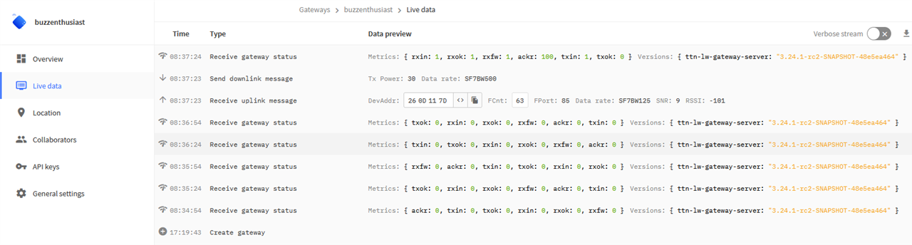

Next step would be to add a gateway into The Things Network with a matching Hardware ID. Once the profile is created, you can enable the radio.
All things working well, you should be able to see the gateway connect and send data at <= 30 second intervals. In my case, it was passing data literally within its first minute!

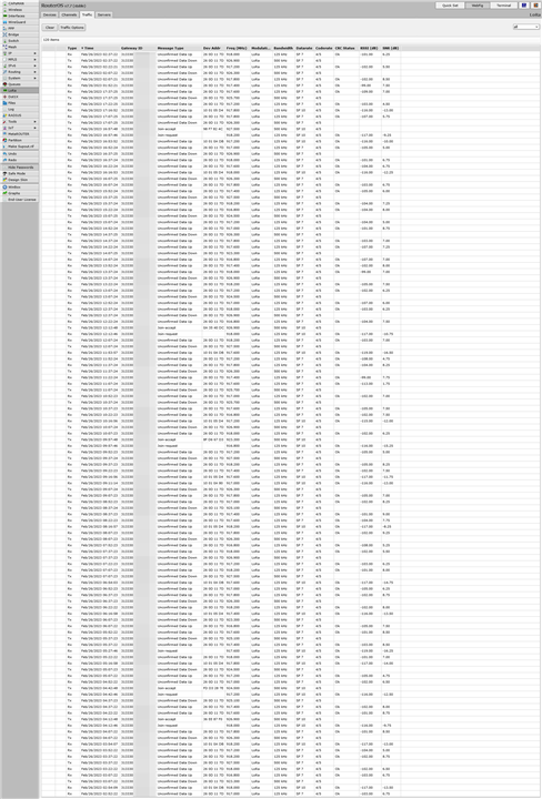

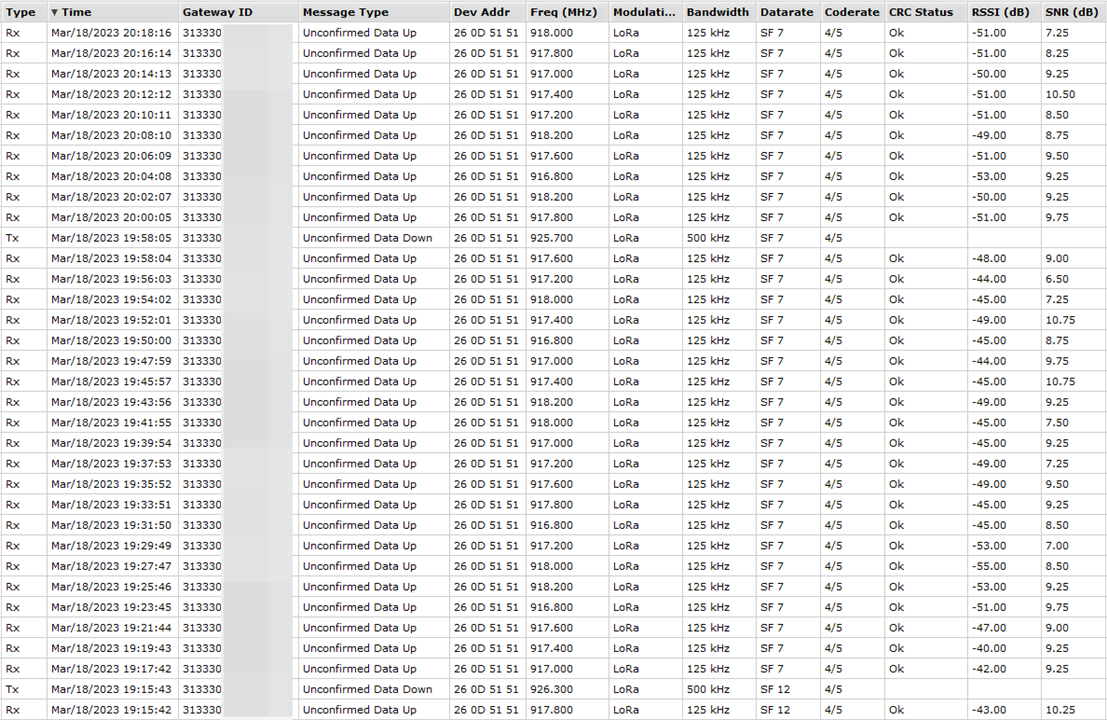

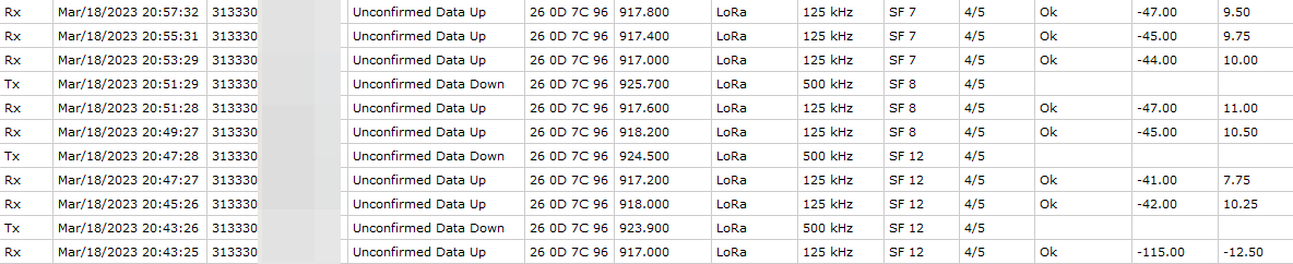

After a day of operation, the Mikrotik traffic log shows the last 120 packets indicating a low level of LoRaWAN activity near me that my gateway is participating in. This is before I even tried to get the MKR WAN 1310 working on my gateway. About a week in, my dashboard on The Things Network shows nearly 1500 frames uplinked and over 600 frames downlinked. My gateway is definitely doing some good work!
I’ve decided to put this gateway into operation in part for my own education, but also to help others in the area who may be interested in playing with LoRaWAN but aren’t otherwise able to get coverage. As a person without a truly permanent internet connection (I rely on LTE and hop providers every month), it’s not ideal for my limited quota or for latency, but some coverage is still better than none! For my own privacy, I have decided not to enable GNSS and have not connected the antenna to the gateway. I have not decided to expose my location to The Things Network either, even though the network could probably work it out (roughly) based on the mix of packets I am receiving.

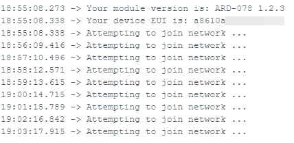

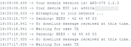

With my sketch from last time and my LoRaWAN-enabled breadboard, I powered up expecting success – I am literally starting up the board right next to the gateway!
Somehow, it was not to be. The code tries to join, times out, tries again … and never actually gets connected.
Was my antenna bad? It was at this time, I regretted hot-gluing the connector to the board to avoid damage or accidents. But with a hot air gun, I melted the glue enough to remove the connection, hoping not to get it into the connector itself.
I swapped in a Molex multi-band flexible antenna instead and the results were similarly problematic. On occasion, it may seem to join … but data just never came through. It wasn’t the antenna … or so it seemed. What’s going on!?!

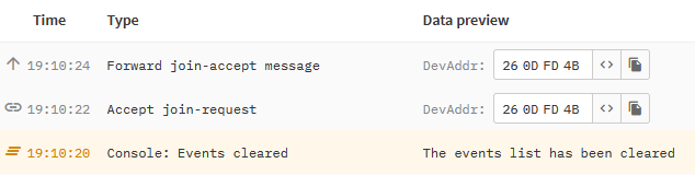

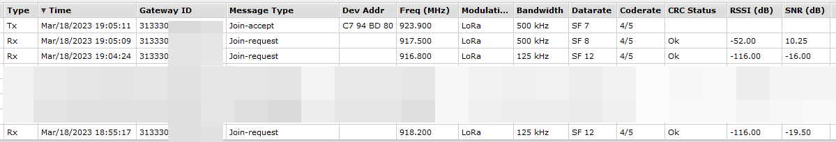

By pure randomness, I found out that if you rebooted the board enough times, it will seemingly join –
Thankfully my local gateway has a traffic monitor that helps a little with debugging.
It seems the first few join requests somehow have such a low signal to noise ratio that The Things Network just ignores it. But then, if the join occurs at the right frequency, the SNR is just fine so the LoRaWAN stack allows it to join.

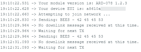

But once joined, it should be sending the string “BEES” over and over at two-minute intervals.
Instead, I see it join and then … nothing. No data whatsoever. Why is this?

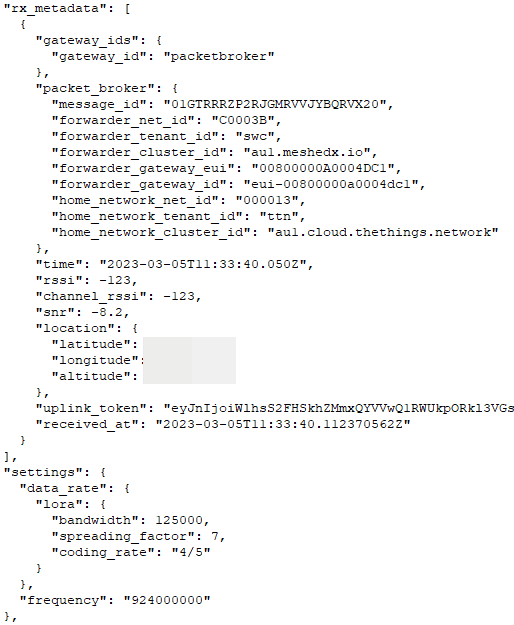

A small breakthrough happened when I left the board running for a while and then saw a transmission getting picked up by another gateway but not my own!
This particular packet came via Packet Broker, a LoRaWAN interexchange network that allows gateways from private systems to interoperate with each other to share coverage based on their own configurable rules which may limit which frame types are forwarded.
That may mean that you have coverage from a LoRaWAN gateway via packet broker that will forward data frames for existing devices that are already connected, but won’t allow you to join the network through that gateway.
Looking at this, the tenant ID of “swc” makes me suspect this gateway is operated by Meshed for Sydney Water Corporation to read water meters. The provided location co-ordinates seem to imply my frame has travelled 12.5km to that gateway! Wow! But did you notice – frequency 924MHz?
image image

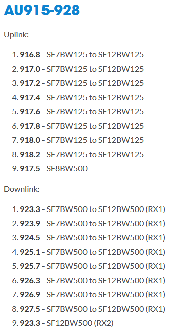

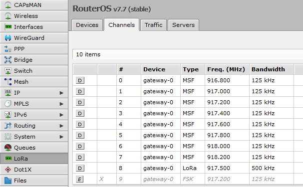

In Australia, the preferred band plan is AU915 using Frequency Sub-Band 2 (FSB2). A look at the listed frequencies confirms that my gateway is correctly configured for AU915-FSB2 operation. But 924MHz is not part of AU915 at all! My board is transmitting on the wrong frequencies and is not getting heard. But as it turns out, 924MHz is part of the AS923 band plan which is permitted to be operated in Australia but not preferred. Many private networks are operating in AS923 because of the proliferation of older imported equipment that supports AS923 and not AU915, hence why my transmission got picked up by a Packet Broker gateway!
As a result, it seems that setting the region on the MKR WAN 1310 sketch to AU915 is not sufficient. It tries joining on frequencies it shouldn’t and it transmits on frequencies that it shouldn’t either. The cause is also due to a peculiarity with LoRaWAN itself.

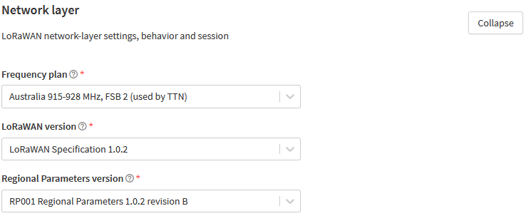

But that, on its own, is not enough. It seems the default settings on The Things Network for an Arduino MKR WAN 1310 with 1.2.3 firmware is not correct.
Specifically, the Regional Parameters version is set to RP001 Regional Parameters 1.0.2 by default. I found that I needed to set it to revision B for it to operate correctly.
This is a peculiarity of LoRaWAN as the bit-mapping of the PHY-level control frames changes between LoRaWAN versions and each set of versions has a set of matching regional parameters. If you don’t know which “set” the device is using, the stack may think it’s telling the device to use a certain set of frequencies, but the device will interpret this incorrectly and end up transmitting on the wrong frequencies which can be difficult to troubleshoot as it could lead to intermittent losses (e.g. 1/8 transmissions in the case of one misconfigured channel). It can also cause advanced features such as adaptive data rate (ADR) to fail. The only real way is trial-and-error if you don’t know … I tried LoRaWAN Specification 1.0.3 and ended up with reliable joins but wrong frequencies, for example.
