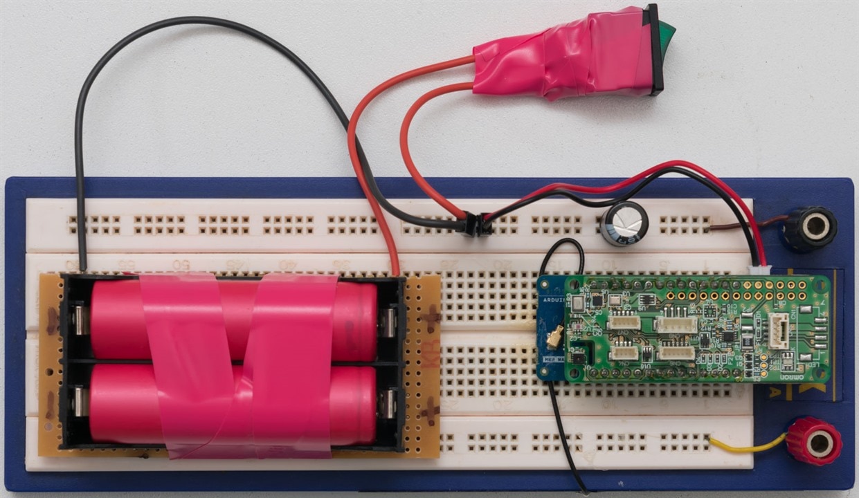

  • Adding a Battery

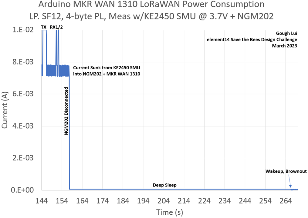

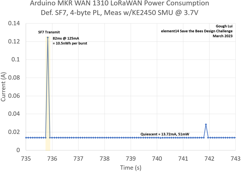

To measure power, I started off with the example sketch in the previous blog and employed the Keithley 2450 SMU in 1A current range (due to current peaks requiring >100mA). I connected the power through to the JST header for the battery, to bypass any additional quiescent current and loads from the USB port.
Starting up and doing an SF12 transmission, we can see that the transmit burst reaches 125mA while the quiescent current is 13.72mA. The long transmit time allows the signal to reach further, at the cost of energy, costing 160nWh for the transmission. Smaller blips are visible post transmission which seem to correspond to RX1 and RX2 receive windows.
Later, the board kicked into SF7 mode, which shortened transmissions significantly to the point the SMU’s default 1 NPLC mode struggled to resolve the length of the burst accurately. I estimated an energy requirement of 10.5nWh.
But there is more to be had from the board – notably the use of the Arduino Low Power library. I modified the code to use the library and to take some hints from this thread to disable the USB connectivity to minimise power.

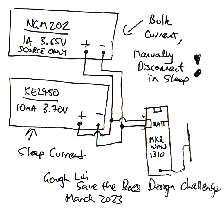

Unfortunately, the low power code worked too well, such that the KE2450 SMU couldn’t accurately resolve the current consumption while in sleep.
Because of the issue of burden resistance causing significant voltage drops, using a DMM to measure the current would also be rather tricky especially as the power goes from 125mA+ during transmission down to <1mA in sleep.
I decided to use a bit of an unorthodox arrangement with the help of my Rohde & Schwarz NGM202 to provide the bulk current during transmit bursts in source-only mode. Unfortunately, it will sink some current despite being in source-only mode, so as soon as I’m confident the device has gone into sleep, I disconnect the NGM202 entirely leaving the KE2450 supplying all of the power to the MKR WAN 1310 in sleep. I selected 10mA range on the KE2450 as this allows for more resolution, although I did try 1mA and it seemed that the transient of disconnection caused the board to brownout causing a falsely-low current measurement.
Using this technique, it implies the standby current of the MKR WAN 1310 is as low as 60.4µA! That’s very impressive. The graphs provide much better justification of this measurement –
The transmission of SF12, RX1/RX2 windows are clearly visible. Once disconnecting the NGM202, we can see the deep sleep current. At 120s further down, it’s clear that a wakeup is attempted and brownout seems to occur, causing a noisy current trace (this proving the unit was happy in deep sleep and didn’t crash until then).
Zooming in, the deep sleep current is very stable, averaging 60.4µA. With such a low standby current, is there any need to save modem states anymore? The board alone would only eat 530mAh per year, which is pretty good for a prototyping board! More savings are likely to be had for well-designed solutions.

Adding Sensors

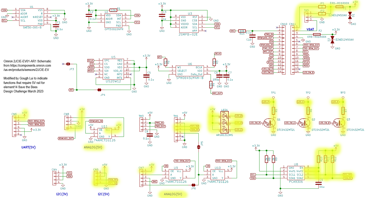

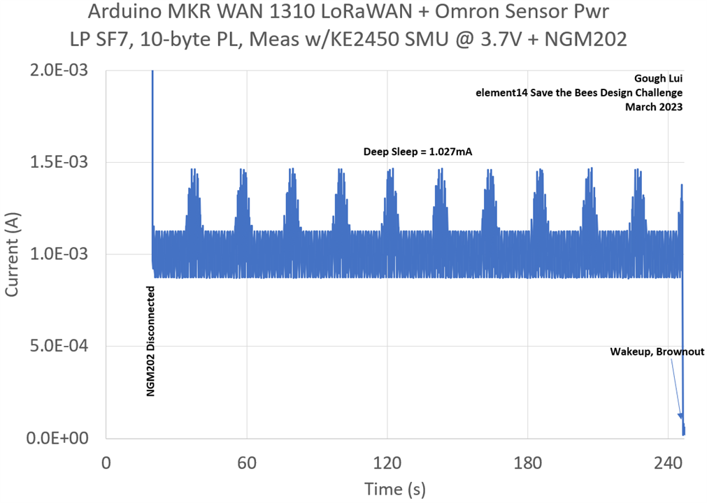

Thanks to being a RoadTester for the Omron 2JCIE-EV01-AR1 in August 2020, I’ve already got myself a nice “shield” that can plug onto the MKR WAN 1310 without the need to design or build anything. I decided to take this shortcut because the board has temperature, humidity and barometer measurements which are relevant to the environmental monitoring I had proposed.
Looking closely at the schematic, however, makes it clear that some sensors and the RGB LEDs require the use of 5V, including the dust and smoke sensor which I had reviewed. Unfortunately, due to the design of the MKR WAN 1310 which does not generate a boosted 5V rail from the battery to reduce energy consumption, unfortunately, I have to give up on that sensor. I did look at alternative laser-particulate monitor sensors, but almost all universally require 5V for powering their internal fan even if communication is at 3.3V, which complicates things.
An option would be to generate a switchable 5V rail which can be powered on when required by the microcontroller through a switching controller’s enable pin. This may be an option if I were intending to make this a serious device. Another option would be to use USB/5V into Vin on the board and an external boost and battery management. However, the quiescent current of the converter under light loads could be a problem and the MKR WAN 1310 may not be as efficient when powered via USB as loads such as the LEDs and PMIC are connected.
I consolidated the code in such a way that it became part of the sketch, as it was originally provided as such rather than in library format.

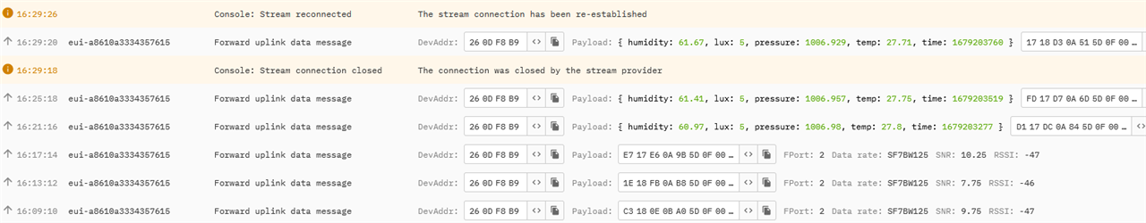

Decoding the Payload
By default, there is a decoder for LED status, or no decoder if you set up your device manually in The Things Network.
As a result, you get data as a raw string of hex bytes. Instead, wouldn’t it be nice if it was interpreted into a nice JSON structure? Well, that’s where having a Javascript parser helps. With the help of this website, I wrote my own and set it up.
The code is listed below:
function Decoder(bytes, port) {
   var decoded = {};
   if (port === 2) {
     decoded.temp = ((bytes[3]*256.0)+bytes[2])/100.0;
     decoded.humidity = ((bytes[1]*256.0)+bytes[0])/100.0;
     decoded.pressure = ((bytes[7]*16777216.0)+(bytes[6]*65536.0)+(bytes[5]*256.0)+bytes[4])/1000.0;
     decoded.lux = ((bytes[9]*256.0)+bytes[8]);
     decoded.time=Math.round(new Date().getTime()/1000);
   return decoded;
Now that the data is interpreted, it can be shared with other applications and parsed, however, that will be the subject for another blog.
Adding a Battery
Given the surprisingly low power usage of the board on its own, I decided to check the power consumption with the sensors connected.
Using the same two-power-supply trick, I disconnected the “bulk” supply after the RX1/RX2 windows to leave the Keithley 2450 SMU measuring the standby current. I left it long enough to see that the board browned out on attempting to restart just to make sure the board was truly in standby and not just “crashed”. Given the timing of the brownout is congruent with the settings, this suggests the standby power readings are valid.
With the sensors, the deep sleep current has now increased to an average of 1.027mA. This is not ideal, but it is very good for a sensor board that has no power gating and no effort placed into power optimisation for the sensors.
To power everything, I decided to grab an old double 18650 cell holder and pair two cells I had salvaged from an old laptop battery. Those cells have high internal resistance but a capacity that probably reaches 5000mAh combined. I charged them with my NGM202 power supply, before putting them into service.
A quick power budget calculation suggests the following:
  • 125mA TX current * 30s/day fair usage = 1.0417mAh per day
  • 027mA standby current * 24 hours/day = 24.648mAh per day
  • Total = 25.7mAh/day
  • Estimated Lifetime = 194 days (!!!)
With this result, do I really need solar power if I only need to attend to it every six months? The challenge should be over before the battery is depleted.
I crimped a few wires, added a bypass capacitor and a switch to the breadboard and it’s now finally untethered from a computer.
Unlike the MKR WAN 1300, there doesn’t seem to be an easy way to measure the battery voltage without using an external voltage divider. Unfortunately, that increases power usage, so I decided to go without, but perhaps this is another thing that a proper implementation may consider adding.
