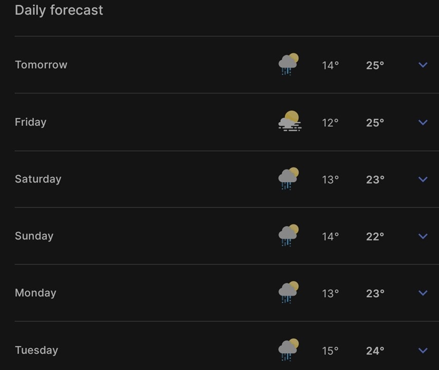

A positive sign is the charging LED on the TP4056 module visibly lighting up with the exposure to the relatively overcast day. In fact, I had to find a break in the rain to put the system out …
… as Sydney has been experiencing consecutive days of rainy weather. Eugh.
I went out several days later and the rain was still pelting down, but the system was still operating and had not blown away. Great success!

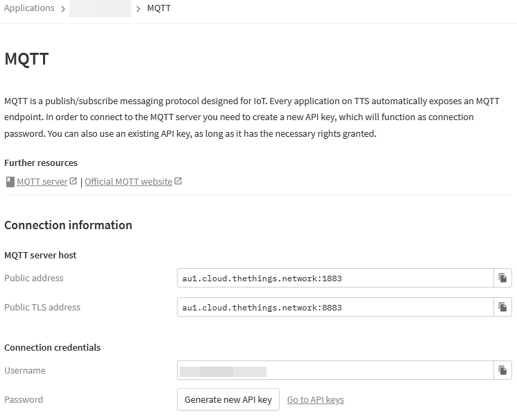

What good is collecting sensor data through LoRaWAN and The Things Network when it’s not being recorded? In some good news, during prior portions, I was already working on this problem.
The first is to activate the MQTT integration and generate an API key to allow an MQTT client to access the data. This is rather simply achieved in the Application -> Integrations -> MQTT menu.
From there, I repurposed some old Python MQTT code that relies on the paho-mqtt library to connect to the MQTT server and dump all the recorded responses into a text log file.

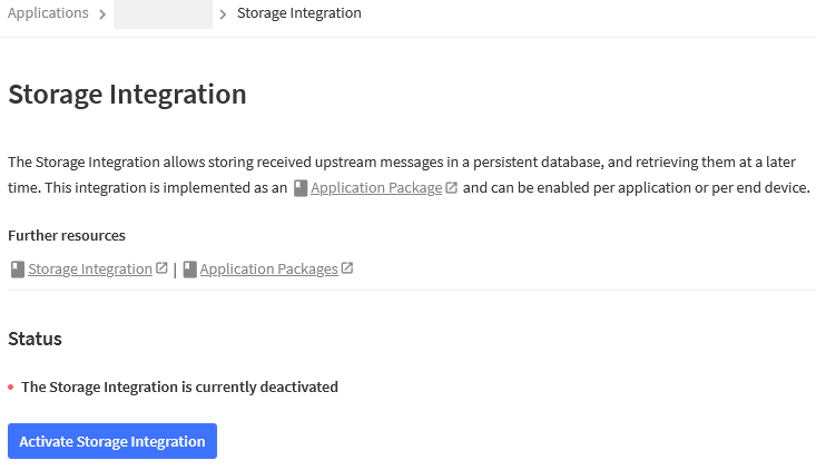

This is a great way to collect data assuming you have a system that is always running and is connected to a reliable connection. Unfortunately, being on an LTE link, I didn’t notice that the modem had rebooted one day and the NAT connection got stale, resulting in no MQTT messages being logged. Whatever was not stored at the time is ultimately lost. Perhaps I should refactor the code to automatically re-connect if no message is received after a while or there is a keepalive setting I am missing.
This is where a different type of integration is perhaps useful – this one is known as Storage.
The Storage API is a basic database which stores all the relevant messages for a certain time window (up to 30-days for paid plans) against which you can use an HTTPS-based API to query it. Unfortunately for free plans, the storage API only offers 24-hours of storage which is not that much, but was enough to patch over one hole in my data. All you have to do is enable it!
From there, you can query the API to get the stored messages based on some criteria (or none at all). This can be done using cURL if you don’t have anything more sophisticated – e.g.
