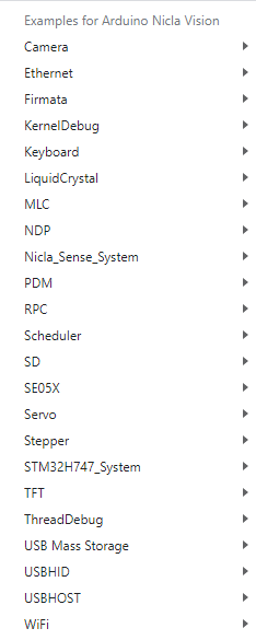

Being quite familiar with Arduino IDE, I decided to go back to basics and “near” bare metal rather than forcing the board to run something as complex as MicroPython. Loading up the examples, the list seems rather extensive:
Upon closer inspection, however, all is not quite as it seems. Some examples are for Nicla Sense and not for Nicla Vision, while others seem generic Arduino (e.g. LiquidCrystal, Servo, Stepper) as the board doesn’t seem to have the level of free I/O necessary to make use of it. Some things I did expect to see (e.g. Wire) are not there!

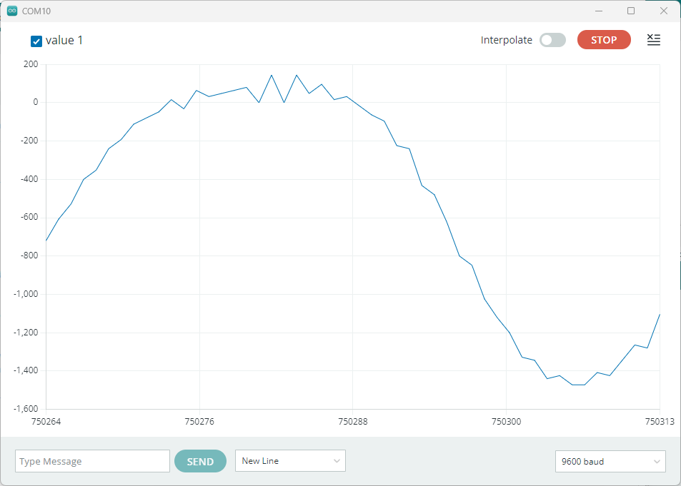

I tested a microphone example which worked quite well – the waveform of me humming a low note is pretty clean even though it’s sampling at 16kHz!

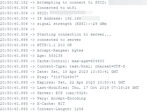

I tested a Wi-Fi example that fetches a page from a server but Wi-Fi wasn’t working just yet …

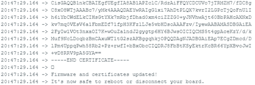

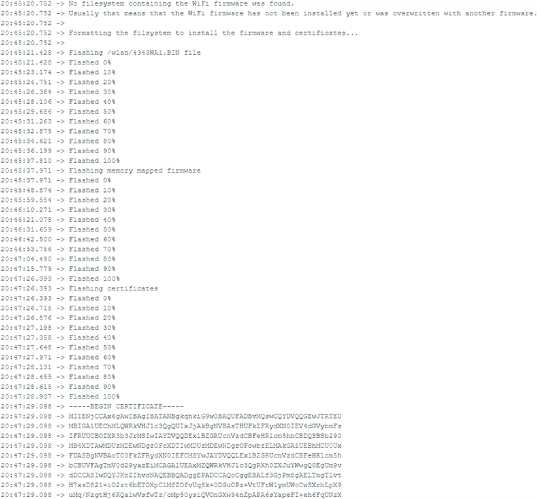

It seems the OpenMV firmware is not compatible with the Arduino examples which expect the flash to have a specific layout with Wi-Fi firmware. Luckily a sketch exists to load/update the firmware:
image image
After it successfully loads, the example sketch works just fine …

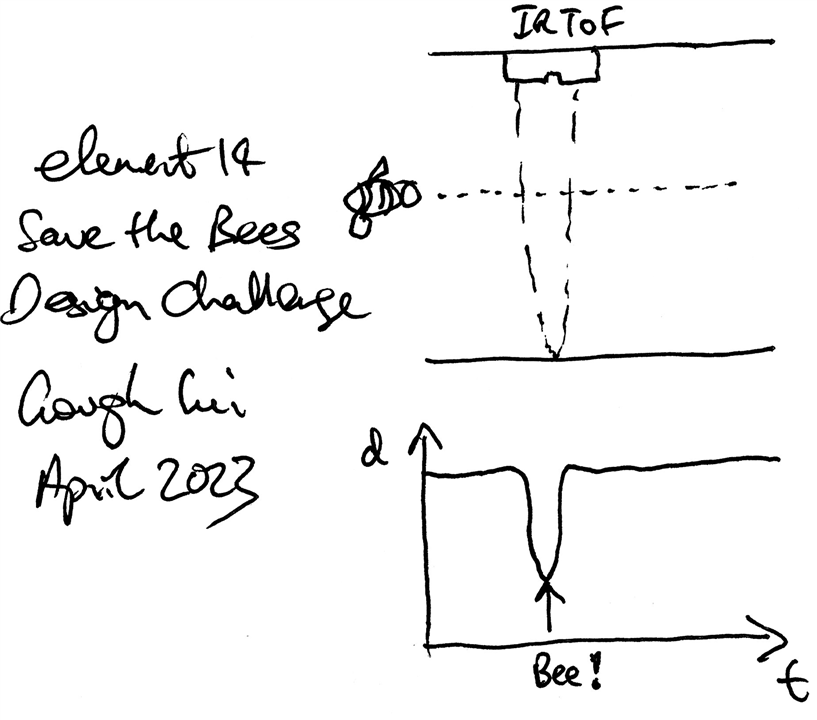

My idea was to use the infrared time-of-flight sensor as a way of counting hive activity. If it is placed across an entrance, then the distance measurements can tell whether a bee is in the path or not – in a way similar to how a laser particulate monitor sensor measures the obstruction of a laser beam by particles in the air.
I would expect the distance to measure the “width” of the opening when no bees are in place, and less than this when bees are in the path. Counting the bees may be possible if they don’t overlap, but that is unlikely, so instead I think it is best to report it as percentage-of-time with the passage “in-use” as a proxy for hive entrance/exit activity.

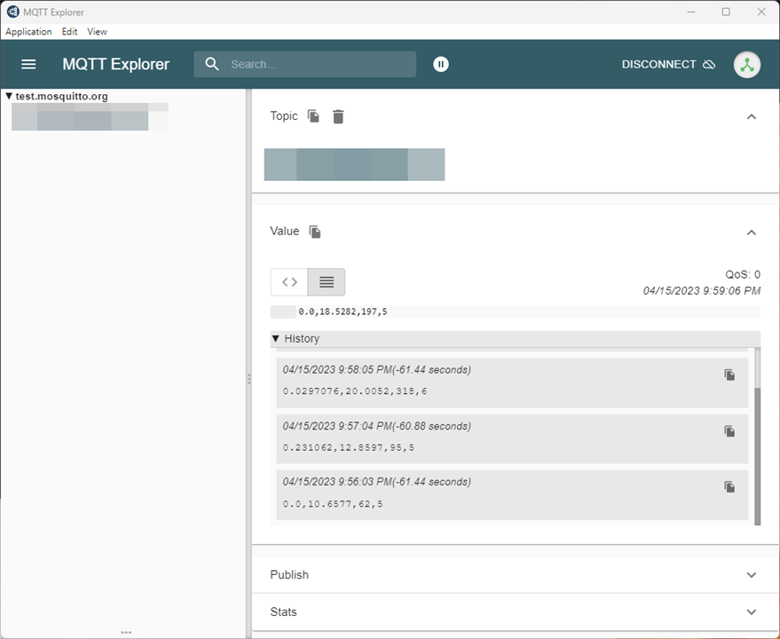

Furthermore, with the presence of a microphone, we can probably just take the audio data to determine hive activity too. My crude approach, which doesn’t filter against non-bee sounds, is simply to measure the average, maximum and minimum amplitudes. This may be enough to identify hive activity but also potentially loud noises or threats.

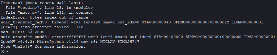

The data would be carried by MQTT – for testing, test.mosquitto.org is being used in unencrypted mode as the example works well with it. I did try with a secure TLS-based server, but instead, I got errors:
Unlike the Arduino case, everything just “clicked” into place with the code below:

The reported data is fraction of time path is in use, average amplitude, maximum, minimum of 256 samples.
Perhaps it would make sense to have a larger sample window, or a better approach will be to update statistics on a per-sample basis, but at least it works!

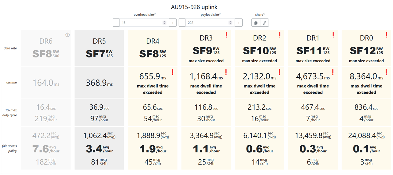

With a board like the Nicla Vision and the MKR WAN 1310, it’s natural to think about the possibility of sending an image over LoRaWAN. However, it is important to remember that LoRa isn’t optimised for speed, but is more oriented at low-rate and long-range. Likewise, the acceptable usage policy for The Things Network free-tier is 30-seconds a day of transmit time. Using more than this is possible using private LoRaWAN or even direct LoRa communications, but this may impede access for other legitimate users – remember, the airwaves are shared!
As a result, I decided to do some computations to see just how much we can get out of the limits using this airtime calculator:
The largest frame we can send contains 222 bytes – this means the least overhead of headers if we can exploit the maximum size. In terms of data rate, DR5 is the fastest for the LoRaWAN standard, which means 81 messages per day maximum for the 30-second airtime rule. As a result, we can send just 17,982 bytes per day assuming we have the best coverage. But there is a catch – all the packets have to be received correctly without acknowledgement – if we have to use acknowledged uplinks, then we are limited to 10 packets per day or 2,220 bytes.
The above is a 16,137 byte image – not particularly big or clear. Therefore, this is probably not a particularly fruitful endeavour.
