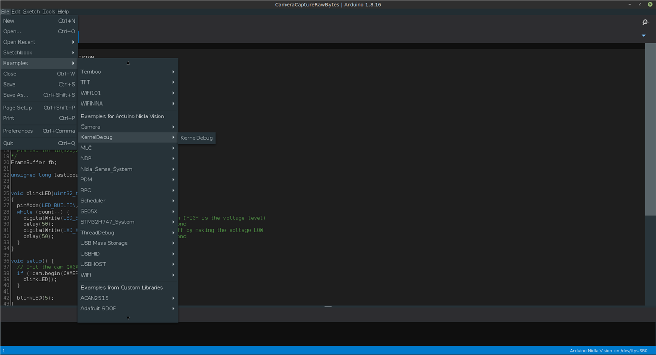

As I already had a copy of the Arduino IDE, I decided to use my existing install. Following the guide from Arduino here, I installed the necessary library.
But this only led me down a confusing dead-end as there was no examples relevant for the board and it seemed to be more for bare-metal development of software which is less interesting.

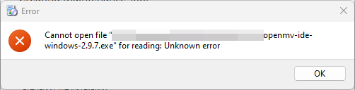

But then, my installation failed with an unknown error …
… as it turns out, you’re not supposed to execute the installation from a Network Drive, otherwise, it will fail. Copying it to local storage and re-executing the install allowed me to complete set-up.

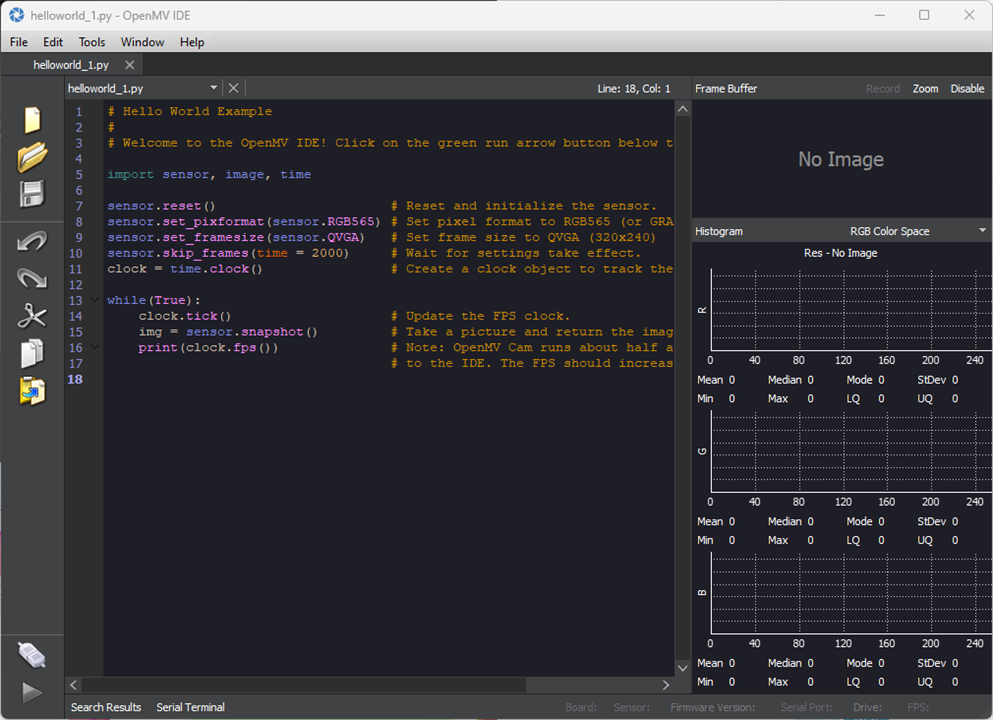

After closing and re-opening the IDE to apply the updates, I am now at the stage of staring down a Python-based helloworld example.

Testing Example Code
In order to run any example code, we must connect to the board in the IDE. As it turns out, connecting the board gives us the warning that the board is out-of-date …

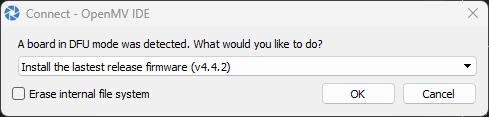

I opted to erase the internal filesystem but then the upgrade failed with No DFU settings for the selected board type! That’s not good.
Attempting to reconnect was slow, but it detected a board in DFU mode allowing me to manually select to install the firmware.
image image
This attempt was then successful, allowing me to start running some code. But the message was confusing - I interpreted the final message as if I had to wait for the blue flashing LED to stop, which never seemed to happen. Instead, I suspect the blue flashing LED means the self test has finished ... so eventually, I got impatient and clicked OK. Thankfully, things seemed to work, although the connection process seems to be a bit slow, resulting in the IDE hanging for about 20 seconds.

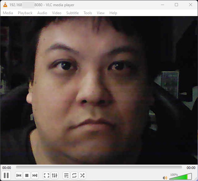

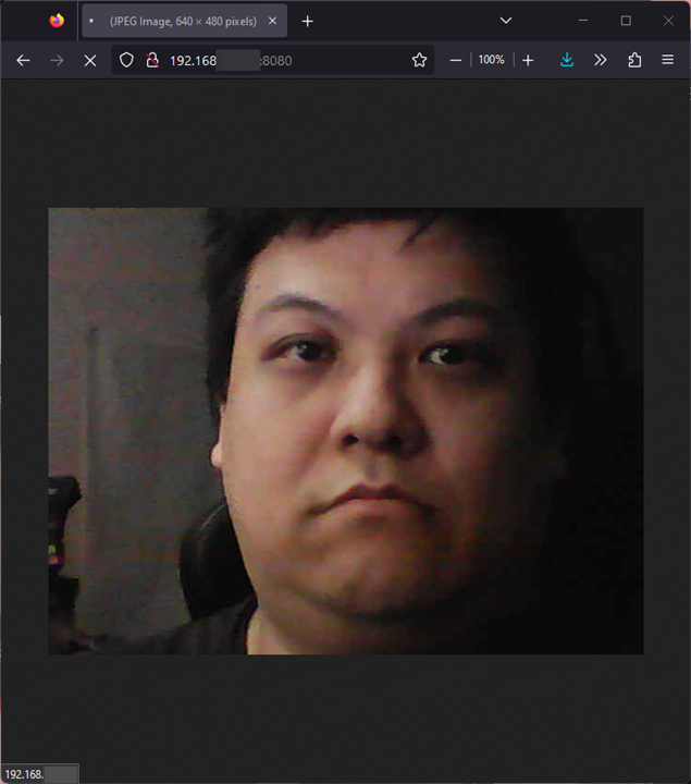

I pushed things a bit further, with the MJPEG streamer example, being able to turn the board into an IP camera of sorts with up to VGA resolution. Unfortunately, quality wasn’t high at the 1Mbit/s bitrate.
image image
While it did work, it was quite strenuous for the board … and when I tried to stop the example … it wouldn’t stop!
Instead, it blinked white, suggesting to me that it had overflowed its internal memory and crashed, hard. Thankfully, unplugging and replugging seemed to bring it back to life.

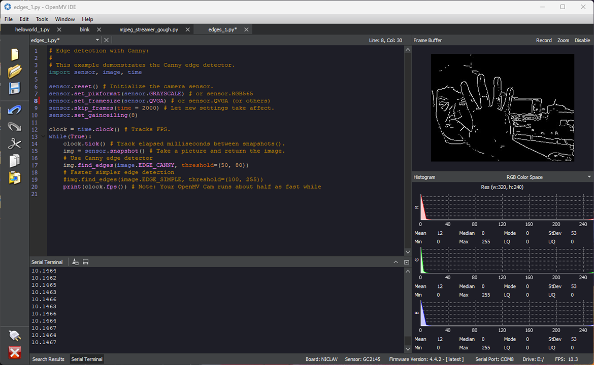

I did try another example, in this case, edge detection. However, the frame sizes are very limited, due to the memory limitations. Similarly, it seems any models trained for the device will have to contend with both limited processing power and storage. It is still pretty surprising it can do as much as it does, but being so used to programming in a C-like Arduino IDE for so many years, and in ordinary Python for desktop applications, the change to use Python in embedded feels unusual to me.

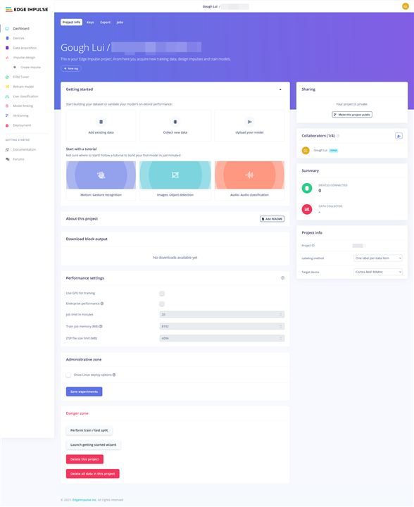

Not having anything to do with artificial intelligence (AI) models until now, I haven’t the slightest clue of how to develop a model of my own on my own hardware. While I know about datasets, various model architectures and annotation of data, I have never actually done this in practice.
Looking at the guides suggests the best way forward is to use Edge Impulse, a cloud-based service, to handle the dataset and train models. Individual developers can use it for free, but with 20 minutes per job, 4GB or 4 hours of data per project and some limited features.
I’m personally not much of a fan of relying on cloud services, especially free offerings, as they come and go. Furthermore, data sovereignty and privacy concerns may mean that certain datasets shouldn’t be uploaded to third party providers and trained there as it may be tantamount to giving the dataset away. While the terms and conditions may state otherwise, the potential for cyberattacks and data breaches remain a risk.
In spite of this, for this project, I think I will have to give it a try anyway … perhaps it can be coaxed to work in my favour, but somehow, I suspect I’ll not have enough data for any robust models.

  • Gough Lui
    Gough Lui over 3 years ago in reply to BigG
    Hi BigG
    Actually, I think this may be a bug. The board was selected - you can see that in the background of the screenshot.
    But what I suspect is that Arduino IDE 2.0 is buggy ... because I just tried it again after your comment and it did show up ...
    So, thanks for the correction ... strange how it didn't come up before because I swear I selected the right board - it's even visible in the background. Perhaps the IDE needed a restart ...
    - Gough
  • BigG
    BigG over 3 years ago
    I love your blogs (well done) and once again you've provided some really great technical detail and insight on how to get started with OpenMV and Nicla Vision. Something I plan apply in the near future with one of my fantastic Element14 prizes. I hadn't realised what OpenMV has to offer Grinning
    However, I just wanted to draw your attention to a comment you made:
    "But this only led me down a confusing dead-end as there was no examples relevant for the board and it seemed to be more for bare-metal development of software which is less interesting."
    This is not quite correct. I suspect you forgot to select your Nicla Vision board in board manager (something I do all the time) and hence you never saw all the Arduino examples available:
