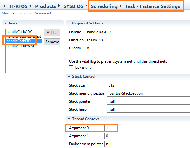

The TI-RTOS FirmWare - Synchronise with Mailboxes and Events
The CCS project is attached to this post. You can us it to check out some neat RTOS techniques: Messaging, Events and Synchronisation.
There are three tasks.
  • PID task manages everything. It's scheduled to run at a given interval by the TI-RTOS.
    It asks samples from the ADC module and tells the PWM task to change its duty cycle.
  • The PWM task sleeps until it gets a command from the PID task to change the duty cycle.
  • The ADC task sleeps until it gets a nodge from PID to give the sampled DC value.

A full cycle of the PID task is:
     while (1) {
         Task_sleep(((UInt)arg0));
         if (! Mailbox_pend(mbADC, &aMsg, BIOS_NO_WAIT) == 0) { // no sample
             Input = aMsg.adc; // todo set to same base as output
             // some calculations that you can check in the source code are removed
             if (pidCompute()) {
                 pMsg.pwm = trunc(Output);
                 /* enqueue message */
                 Mailbox_post(mbPWM, &pMsg, 10);

You can hook up a voltmeter over the output of the RC filter and measure the output level.
If you want to check out what's happening with a scope, the interesting signals are the filters input (PWM signal) and output (DC with ripple)
Check out the project code. It's attached to this blog.
Here are some things you can change in the code and see what's happening:
  • define another set value by changing the multiplier. 0 = 0%, 1 = 100%
     Setpoint *= 0.25; // relative to the ADC reference value (2V5)
  • change the PID parameters
    double Kp= 1; // one duty cycle count
    double Ki=0, Kd=0; // todo make these good values for our strategy
  • change the control loop frequency. Argument 0 contains the sleep time in microseconds.
  • look at the order of events. Is the sample taken at the right time?
