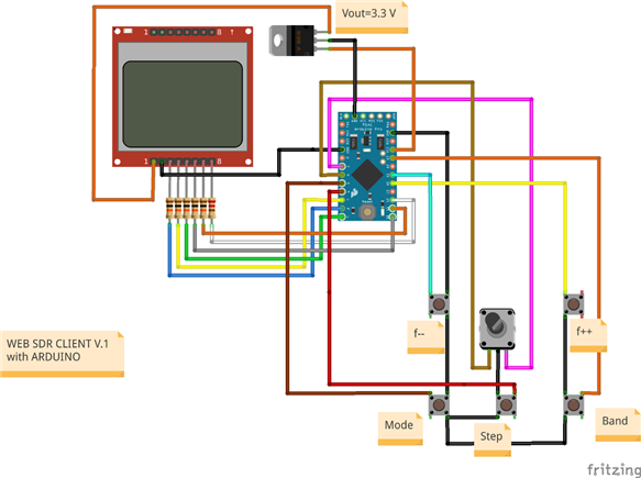

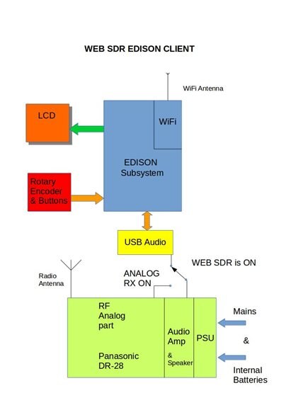

I am visualizing the implementation of an Edison-controlled WEB SDR client, operated from the front of the radio with a Rotary Encoder and push buttons, as follows:
In the front of the radio, we will add a small monochrome Nokia 5110-style graphics LCD screen with a viewing area of approximately 24x34mm.
The LCD is connected to the Intel Edison through the SPI bus; it displays the information as shown in the picture.
Close to the display, there is a Rotary Encoder with a push button and two or four extra push buttons, also connected to the Edison (see description below). There is also an inexpensive USB audio card connected to it so that the audio stream from the WEB SDR can be monitored.
The block diagram for my idea follows:
One half of a DPST (double pole single throw) switch mounted on the radio’s front is used to power the Edison subsystem with the display, while the other half is used to change the audio input on the radio’s original volume control from the analog radio detector to the headphone/speaker output of the USB sound card. In that way, we select either the Analog or WEB SDR mode. Edison’s WiFi interface is used to connect to the Internet.
The Rotary Encoder is used to increase or decrease the desired frequency according to the resolution (Step) that is being selected from the Rotary Encoder’s push button.
The Steps are 10 Hz, 100 Hz, 1 KHz, 5 KHz, 9 KHz, 10 KHz, 100 KHz, 1 MHz, and operate in a cyclic mode; we set the default to 9 KHz (for wideband AM reception in Long and Medium wave bands). Optionally, there are also two buttons, up (f++) / down (f--), that are connected to change the frequency, instead of using the Rotary Encoder. We can wire up both the Rotary Encoder and the two buttons, or either of the two.
There is another push button responsible for the selection of Mode. Mode is the type of demodulation that is being used for reception. Available Modes are AM (Amplitude Modulation), CW (Carrier Wave), LSB (Lower Sideband), and USB (Upper Sideband). The operation is again cyclic and the default Mode, which again can be changed from the software, is AM.
The last push button is Bandand through it, you cyclically select one of the predefined bands that you can store in the sketch. Initially, 11 bands have been set, but we can predefine others too. Upon selecting a Band, it is displayed on the LCD in wavelength, as Shortwave bands are many times referred to in that way (e.g., 14MHz is referred to as the 20 meter Ham band).
All functions and start up values are predefined and can be customized to one's personal preferences.
A theoretical implementation of the schematic is shown in the picture. As Edison bus is on the 1.8 Volts signal level instead of the usual 5 or 3.3 Volts, there has to be some sort of level shifting in the final version of the project with a standalone Edison Computer module or via the Edison breakout board. That is not needed in the Intel Edison board for Arduino displayed below.
One more digital line is used to control the Backlight of the LCD through PWM.
As I did not have an Edison system available, I decided to initially breadboard and test this idea with an available Arduino Pro Mini, the Nokia LCD, the input control buttons and the Rotary Encoder. The diagram for this prototyping which is operating on my workbench throughout is given hereunder.
