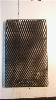

Well, before wrapping it up, I had to open my receiver, carefully remove the antenna wire and the battery connections and put away the back comer. Then I removed the power supply, the speaker, the logo name plate and eventually the speaker metal front grill.
Getting ready to be recycled/imageimage
I decided to use a plexiglass front plate from a scrapped device that was a short of magnifying glass as well.
I mounted the Edison block on it with four screws. The most difficult part was to find a knob for the joystick button. All the possible places that I visited had knobs that had a larger square diameter than the one that was needed which was 2.2 mm. That was a problem. I should have thought of it earlier, but I was always under the impression that shops that sold such joystick buttons, would also have the right knob for it. As that was not true, I thought that I could print a 3d button from the local 3dhub print shops, but I needed the file in the right format for it. Delivery was next day, so I was still withing my plan. But I did not find such file. I contacted Sparkfun’s support, but they only had the pdf file of the switch that I had in the meantime traced (SF303GJ26-3).
So I decided to make one myself with the help of a friend that is more experienced on such mechanical tasks. The plastic axle of an Alps potentiometer was used for the purpose, as it had a small hole in the center. It was cut in the right length and the hole was enlarged to 2,2 mm so that it could be fit on the joystick. It was successfully fitted by 03:15 on Thursday morning and to mark the occasion we named our effort as the Midnight project.
We also had to change the two buttons on the OLED board, with ones that had longer axle, but that less difficult. We then cut a conical hole on the plexiglass for the joystick button and by 06:30 on Friday morning the Midnight project was over. During that time we also had to cut and bend the grill, fit a new 2 gang push button change-over switch and put everything together using simple tools. It was a great experience for me.
