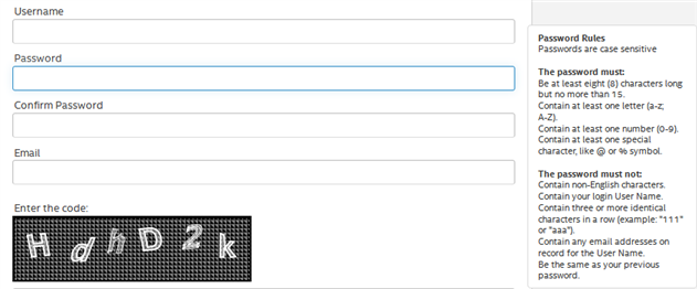

I'd join BUT
Really ... it's a forum, and these stupid password rules have been shown to be ineffective.
I don't have issues with 6 characters and uppercase, but 8 characters and a special character.image

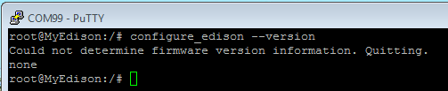

The proper method of finding the version number of the image is to type this in a PuTTy session.
configure_edison --version
However mine comes back with
You should be able to find out using
cat /etc/version
Many of the other posts on the internet have a number, or other information.
I'm assumming this was the 8th day of July 2016 at 1705.
But equally being american it could be the 6th day of August 2016 at 1705.
I guess we'll need to quantify that ..
I found this piece of information provided by Intel
https://communities.intel.com/message/387630#387630
Your Edison is indeed flashed with the latest image, and everything seems to be fine.
Regarding the configure_edison --version command, it doesn't retrieve the version on this Yocto image, that’s why I asked you to run the command cat /etc/version instead, because the configure_edison --version doesn't provide any useful information on this image.
So it seems that the later versions don't have it in.
Not sure why someone would think that's useful (removing it) but ....

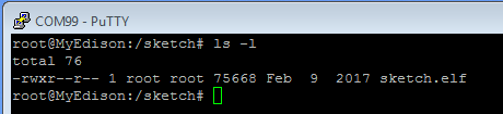

The first is where does it download the sketch to
A bit of digging finds it hiding in /sketch directory
I'm concerned that while the line in the upload says "Deleting existing sketch on target"
#Move the existing sketch on target.
echo "Deleting existing sketch on target"
"$fixed_path/lsz.exe" --escape -c "mv -f /sketch/sketch.elf /sketch/sketch.elf.old" <> $tty_port_id 1>&0
The reality is it performs a rename function
So there will always be the new sketch and the one you had there previously.
They do talk about running out of space and deleting sketches and now you know why ....

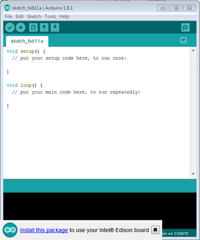

I'm using Arduino IDE 1.8.1 and it looks like it has some clever stuff in it.
I fired up the IDE with the Intel Edison plugged in, and it immediately gave me the option to get the board
This means it has detected the board you're connected to and prompted you to install it .....Nice.

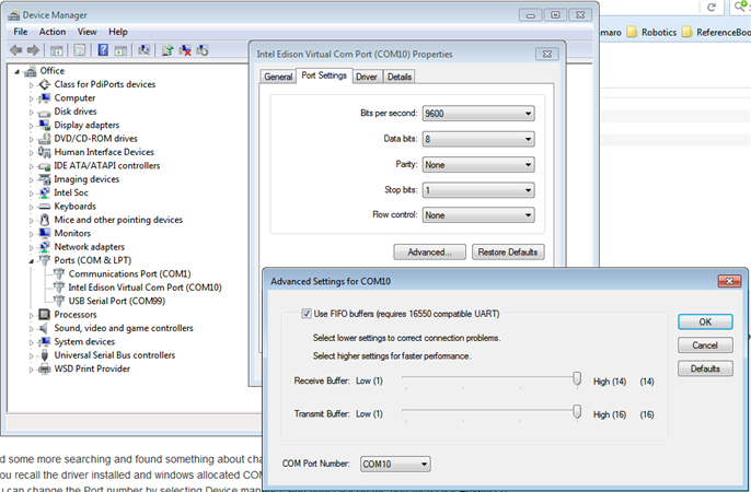

It seems that my home computer can't upload to the Edison.
I'm getting the same refusal message about Read-only file system.
C:\Users\Beckettm\AppData\Local\Arduino15\packages\Intel\tools\sketchUploader\1.6.2+1.0/clupload/cluploadEdison_win.sh: line 56: /dev/ttyS97: Read-only file system
I don't believe it is the Intel Edison and must be a driver issue.
Searching the internet raised a couple of questions about permissions, since the COM port is converted to a TTY.
There is no ability to change the permissions of COM ports in Windows.
I did some more searching and found something about changing the port number.
If you recall the driver installed and windows allocated COM98 (and COM99).
You can change the Port number by selecting Device manager, and right click on the Intel Edison Virtual Com Port, port then click Port Settings and Advanced.
Change the COM Port Number by selecting the drop down and highlight the one you want.
Windows might complain that the port is in use (meaning it gave it to someone else), but you've got nothing to lose.
I set mine to 10 ... for no real reason and tried again.
This time my upload was successful, and the light flashed.
