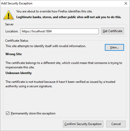

Creating a certificate
I'm developing on windows so I used a simple powershell cmdlett to create the certificate in my local store.
New-SelfSignedCertificate -DnsName "workshopshed.com", "www.workshopshed.com" -KeyFriendlyName "Workshopshed"
I then extracted the certificate and private key as a .pfx file with a simple password. This needs the format converting before you can use it with an MQTT broker so I did that with ssl-converter and ended up with a .PEM file.
Note, that you can also do these steps using the OpenSSL toolkit or you can create a real certificate with something like LetsEncrypt
Configuring the MQTT Broker
To run Mosca with a certificate you can add a couple of command line parameters.
./mosca -v --https-port 1884 --only-http --cert TestCertificate.pem --key TestCertificate.pem

The client uses the Web Browser to determine the certificates so we can add the test certificate viewing the certificate manager, adding an exception by browsing to the location of the mqbroker and getting the certificate (Firefox). It will likely report that this is the wrong site and is not trusted. You can view the certificate to confirm that it's the one you added to the broker.

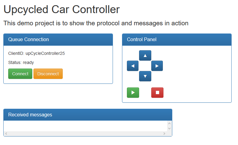

On the client I create my messages as follows:
       var message = new Paho.MQTT.Message(JSON.stringify({ action: "DOWN", timeOut: 1000}));
       message.destinationName = 'E14_UCDC/MyClientID/Commands';
       client.send(message);
And on the server, the listener converts this back and passed them over to the controller for processing.
client.on('message', function (topic, message) {
    var command = JSON.parse(message.toString());
    controller.addMovement(command);
    console.log(message.toString());
This decouples the listener from the commands so that I can add new commands into the controller in future without worrying about the transport.
My controller queues up the messages and can play them back when it receives a "Run" command.
