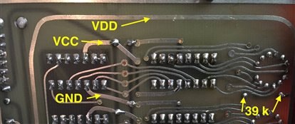

In the second post the hardware of the pulse counter was explored. From this investigation I learned that it should not be to difficult to modify the counter, by removing the 7490 TTL counter ICs and replace them with a connection the Edison with some I2C I/O extenders. The power of the unit also should be enough to power the Edison. More information in blog post 2:image
[Upcycle It] Nixie Display #2 - Investigations

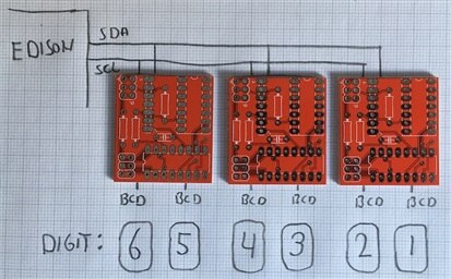

In blog five I switched back to the hardware. A circuit and printed circuit board was designed for PCF8574AN, 8 bit I2C I/O extenders. Three small PCBs with header pins wil fit into the 7490 sockets. Connection to the Edison is via I2C.image
[Upcycle It] Nixie Display #5 - I2C Interface to display drivers

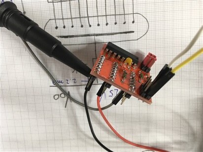

Blog seven is about soldering and testing the Extender PCBs which just arrived earlier that week.
[Upcycle It] Nixie Display #7 - Interface PCBs

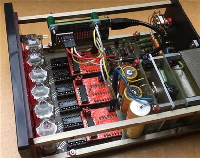

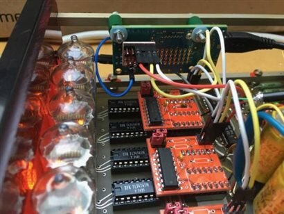

In blog nine I switched to the other Edison with the Mini Breakout Board and mounted this board inside the display case. This blog has a lot of images, to show the process of putting it all together. Updating and installing the Edison was not a big issue, but then I came at a point that I completely overlooked. The GPIO levels of the Mini Breakout Board are 1.8V, instead of 5V like with the Edison Kit for Arduino and GROVE kit. I ordered a Sparkfun bi-directional level converter with four channels and put it between the Edison board and the I/O extenders. I also made a power connection from the counters power supply to the Edison and made connections to the front button of the counter.image
[Upcycle It] Nixie Display #9 - Hardware hacking

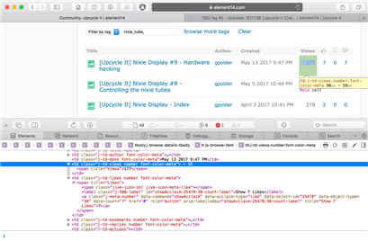

In the application I promised to display some arbitrary information, for which no API or protocol is available. The technology to do this is called Web Scraping. With this technology you can extract whatever you can find on the internet and show it on the display. As an example I've chosen to display the number of views and likes of my most recent blog post in this challenge. image
[Upcycle It] Nixie Display #11 - Display blog views and likes
