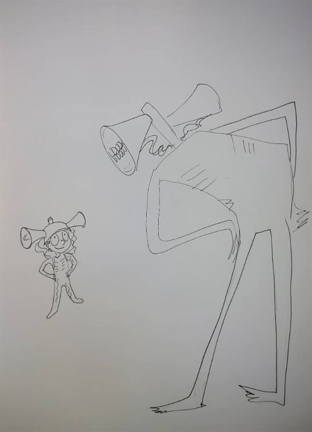

(My early concept art.)

On a lesser scale, I would love to tighten up the design. Perhaps making my own megaphones would be a better option. It would be far less weight.
Originally, I was going to add some robotic or mechanical mouths inside the sirens. But, I had almost no time to get it done. So, this would definitely be part of a continued design.
Although the helmet is a good way to mount things, I didn’t really like the shape. I wanted something like a “hard-hat fez” instead. A cylindrical hat would look more like Siren Head’s post-like neck. So, I would explore fez hats or something like them. image
