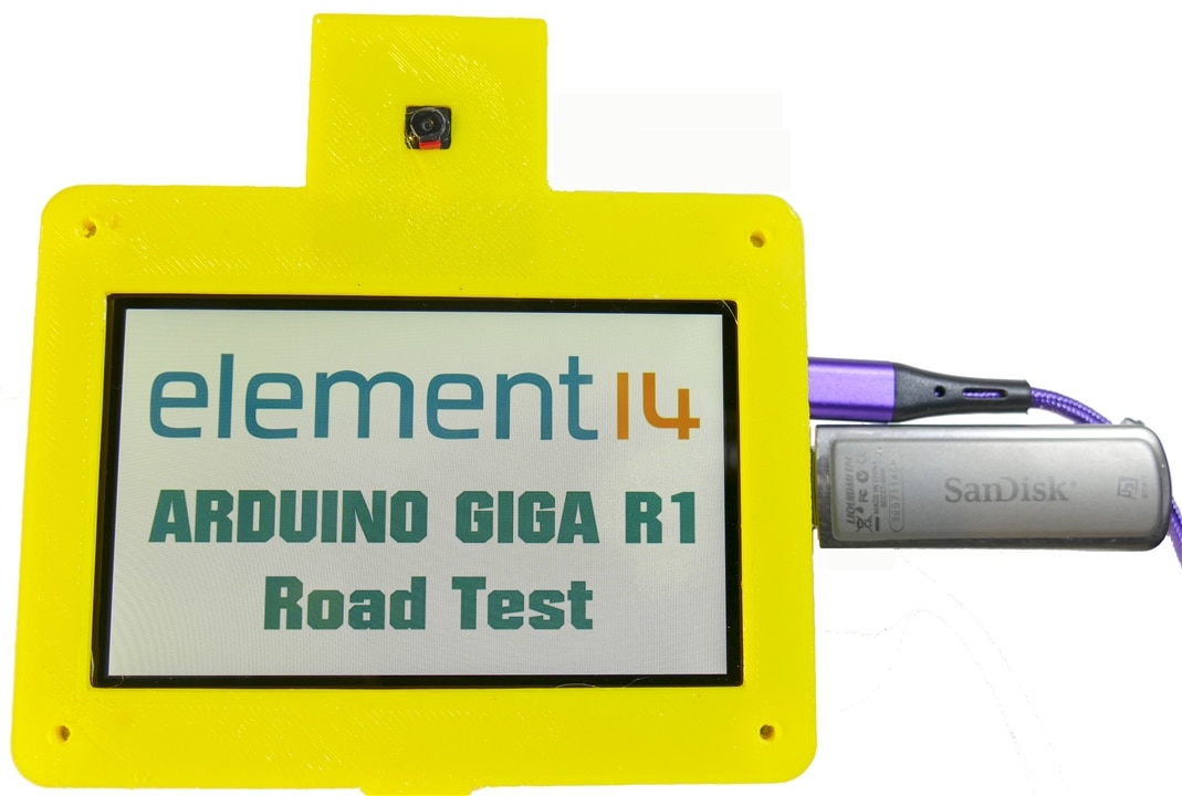

Intro
This is the second installment of material that will contribute to a road test of the Arduino GIGA R1 and its LCD.
The Arduino web site has an example of how to display an image stored on a USB memory stick, but it needs the IDE serial monitor to work. I wanted to operate stand-alone using the touch screen to step to the next image.
Here is a short video showing the result:
Giga Touch USB Image Demo
The images stored on the USB memory need to be 800 x 480 in RGB565 format (binary). These images end up being 768 kbytes each so it is useful to store them on an external USB memory device.
Here is the firmware program:
Firmware

Discussion
The Arduino GIGA R1 has many individual features that can be combined to produce really impressive functionality. In the road test I want to go a bit beyond what is available in the already extensive set of demo examples. This demo uses the LCD, the touch screen, and the USB host interface to create a touch controlled slide show of images stored on an external USB memory device. I am blown away at how simple it is to create a demonstration with this level of complexity. I just needed to integrate a couple of demo programs and of course generate some nice images to display. Initially I had some extra touch events that caused images to flash by, but eventually I figured out how to obtain decent control. There are lots more features to explore....
