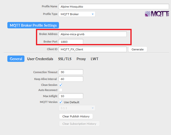

You can use MQTT.fx, the mica Node Red container or your favourite MQTT client to test the connection:

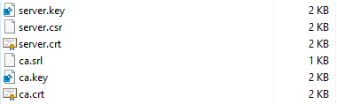

You should now have these 6 files.

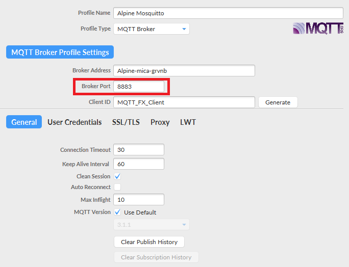

Test. stop and start the service
rc-service mosquitto restart

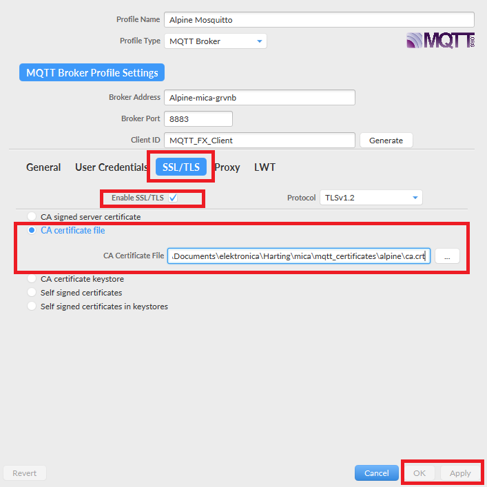

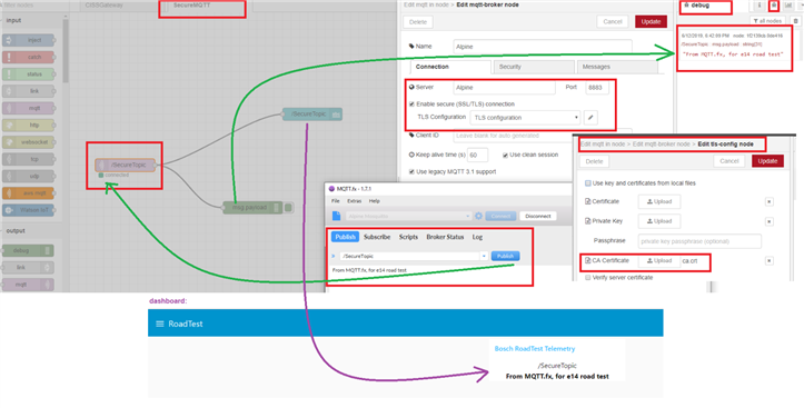

I used MQTT.fx again. I adapted the existing configuration.
You'll need to have ca.crt stored on the computer you are testing from.

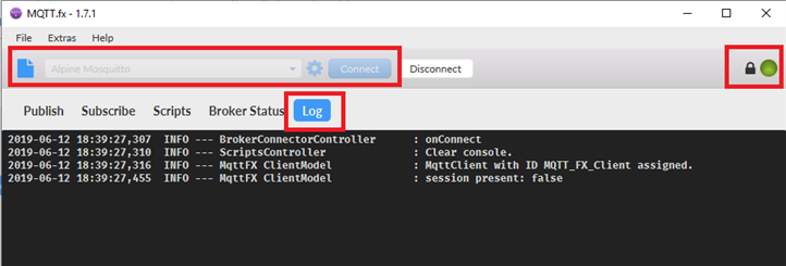

Test!
I also tested with the Mica Node Red container:
