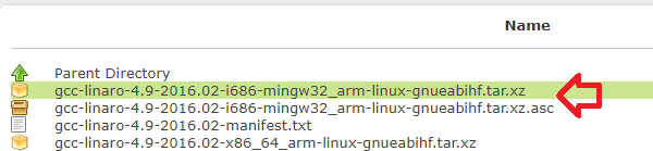

Download one of Linaro's cross-compile toolchains. HARTING proposes to use the same version as used to compile their Linux containers.
Place this file on your computer. We'll have to unzip it.
It's best to place it in a permanent location where you want to keep the tool chain on your computer.
The easiest way is to use 7-ZIP. You have to start 7-ZIP as ADMINISTRATOR. Failing to do so will give you a non-working tool chain.
7-ZIP has to make symbolic links during the extract and that requires administrator rights.
in 7-ZIP, navigate to the .tar.xz file and open it.
Then select the .tar file that's shown in the list. Press the Extract button. Don't exit 7-ZIP.
When this is finished, navigate to where you extracted the .tar file in 7-ZIP and open it.
Select the line in the list (it starts with gcc-linaro...). Press the Extract button.
When you get a prompt for existing files, select Replace All.
Done! You can exit 7-ZIP now.
If you accidentally extracted without elevated Admin rights, you'll get error messages. In that case, delete everything that's extracted, run 7-ZIP as admin and start over.

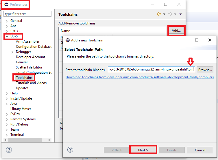

Next action is to register the tool chain in Eclipse.
Go to  the menu Windows -> Preferences, and add the tool chain you just installed.
You have to navigate to the bin path under the install folder.
You now have a cross-platform build environment.

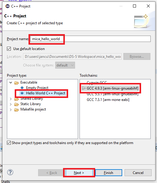

It's time to create and build our first C++ program.
Go to File -> New -> C++ Project.
Name it mica_hello_world.
Select Hello World C++ Project. In the tool chains box, select the one you just registered.
Click Next, (you can change the settings on the next page if you want), then Finish.

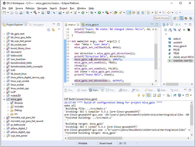

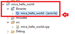

Congratulations! Your first cross-built binary can be seen here:
We're ready for the big step now. Deploy to the MICA and step through the code.

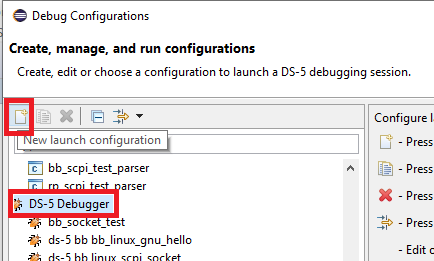

We'll now tell Eclipse how to deploy the binary and how to start the debugger on the MICA.

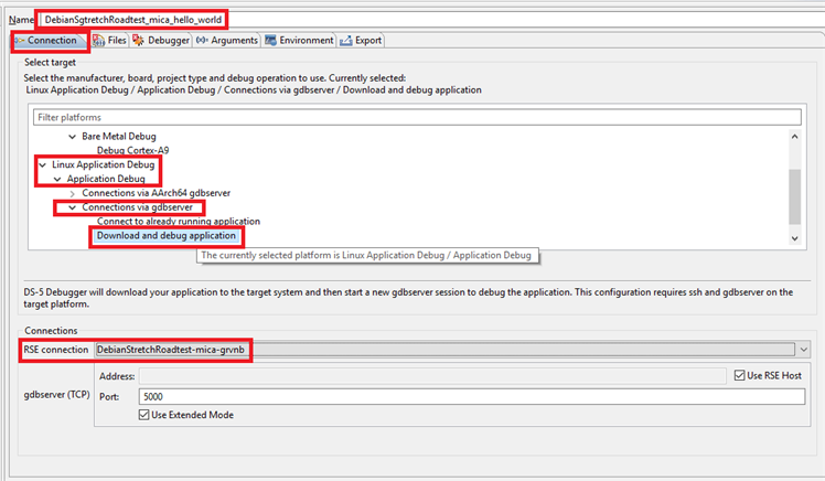

Go to Run -> Debug Configurations.
Select the DS-5 Debugger entry and click the New button.
In the first dialog we get, enter the following info on the Connection tab.:
(because a debug configuration contains the connection to our device, I prefer to put the target container in the debug name).
Select the Linux Application debugger shown below:

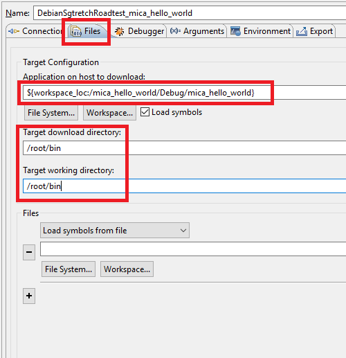

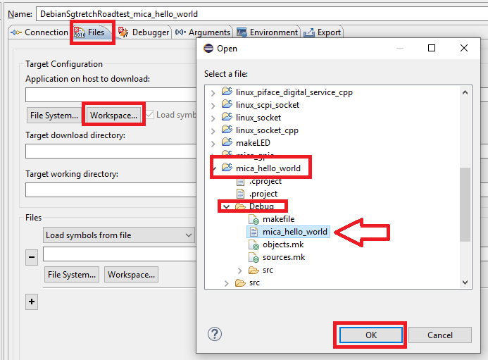

Click on the Files tab and enter these values:
Target download directory and working directory: /root/bin (we created that in the previous post while configuring the Debian Stretch container).
Click Apply.

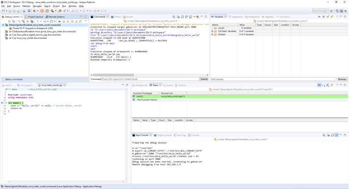

Click Debug (It's happening !!!)
If all is OK, you will end up with a situation like below:
Eclipse opens the Debug perspective.
Your binary is uploaded to the MICA, the debug server on the MICA is started and the Eclipse debugger halts execution on the main() function.
You can now step through the code and look at the various consoles and debug windows.
When you step over the line that starts with cout, you will see the message logged in the App console window.
The debugger does that for you. It routes the standard output to Eclipse so that you can see it while debugging.
