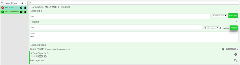

Step 3, you can test if the MQTT server has basic functionality.
Here, I'm doing that with MQTT Lens:
If you change the server name to MQTTRoadtest in the CISSGateway, Node Red and GPIO examples, things will also work with the new service because our server is unsecured.

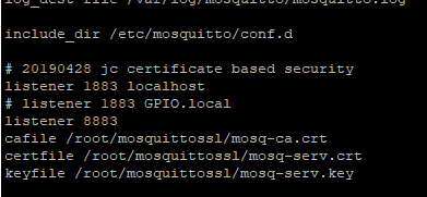

Step 2, we configure the Mosquitto Server to Secure MQTT with the certificates.
Edit the Config file.
nano /etc/mosquitto/mosquitto.conf
Add these entries:
listener 8883
cafile /root/mosquittossl/mosq-ca.crt
certfile /root/mosquittossl/mosq-serv.crt
keyfile /root/mosquittossl/mosq-serv.key
I think that the proper way to do this is to create an own config file in the /etc/mosquitto/conf.d directory. Comment below if you know it.
Next restart the server.
service mosquitto restart
The default unsecured listener in port 1883 is still running now. But we've added the secure service on 8883.
We'll refine later.

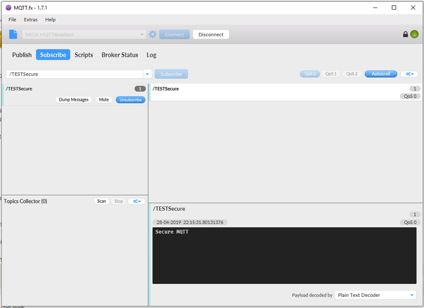

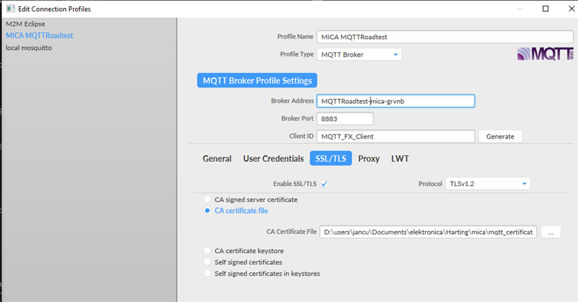

Step 4 is to test it from your pc, with the certificate.
The MQTT testbed I use to try out communication with certificates can be downloaded here: MQTT.fx .
Configure it as shown below, then connect.
Subscribe to topic /TESTSecure. Then Publish to that same topic /TESTSecure with message Secure MQTT.
You should see the message arriving at the bottom of the window. It has gone via the MICA over secure communication.
Step 5 is to revoke the unsecured 1883 listener.
Disable the 1883 port for anyone except the container itself.
edit the msquitto.conf file.
Add
listener 1883 localhost
before the 8883 listener.
Restart the service.

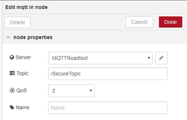

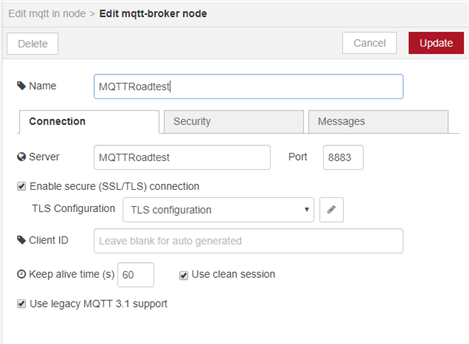

Step 6 is to test with the NodeRed container with a self-made flow.
Create a new NodeRed process, with a MQTT and a Debug block:
Edit the mqtt node. Replicate the settings as shown below:
Deploy, and then it's time to test.

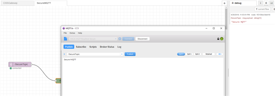

As a preparation, open the debug window in the Node Red editor:
You can use the Selected Node filter to only see debug messages for this flow. Do that in case you have the CISSGateway running - we don't want to see those messages now).
Use the same MQTT.fx connection we used before, but publish some message to the topic /SecureTopic (the same one used in the Node Red process).
Go back to the Node Red editor. You should see the message in the debug log:
