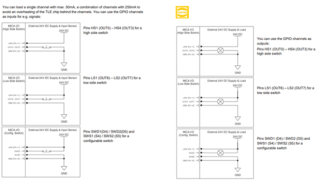

image source: HAIIC MICA Hardware Development Guide
This is the end goal of this blog series (hang on, there's an extra one that shows a solution that uses much less memory and disk space): How to set up an interactive environment where you can write code, deploy, test and debug.

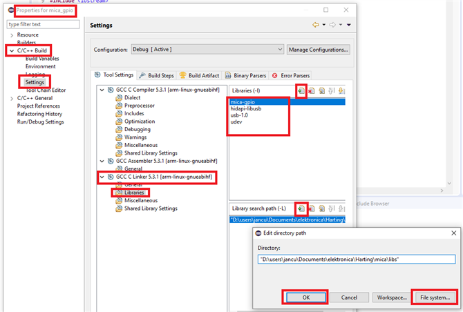

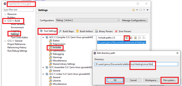

Next, add the location of the headerfile to the Eclipse include path.
Then, add that same folder to the library search path, and add the libraries to the list below the path.
Libraries to add:
mica-gpio
hidapi-libusb
usb-1.0
udev
Type this exactly as above, without lib at the beginning or .so at the end. The tool chain will take care of that.
It will look in your path folder for the libs at link time.

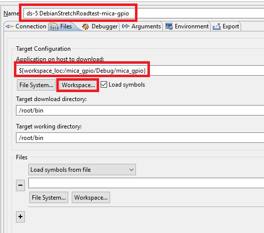

Just like when we tried the Hello, world! C++ program, we have to create a Debug configuration.
We can copy the one made in post 3 (right-click on it and select Duplicate), and adapt it:
The only two things you need to change is the name and the location of the binary file.
Then click Apply.
Then Debug.
