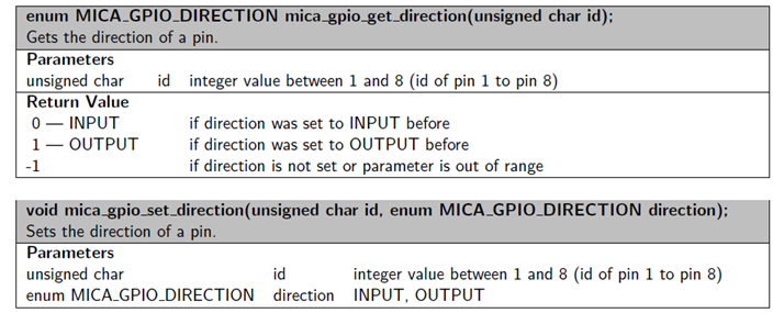

Example GPIO API functions:
source: HARTING MICA GPIO Library Documentation
Fun fact: the GPIO pins are industrial range. In my case 24 V image.
The example first registers a listener for I/O changes, then does manipulations of I/O pin 1.
It will set the output direction and values, and read them too.
All the time, the listener will wake up when the pin changes, and logs info (that you can see real-time in Eclipse running on Windows if you are debugging!)

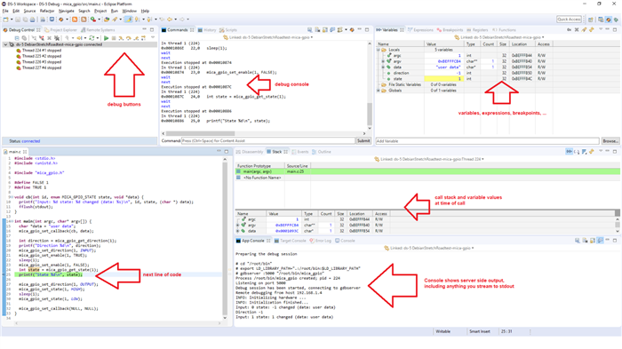

What Does Eclipse Offer?
The Harting example lets you build your code on the MICA, from the command line.
I want to up the user experience by showing how it can be done from an IDE, with build and debug integration (and version control integration is possible too).
goal: How to set up an interactive environment where you can write code, deploy, test and debug.
I'm using he ARM DS-5 Community version of Eclipse. It offers a cross-compile and remote debug environment.
The compile and link toolset is Linaro's Windows cross-compilation suite with Linux ARM as target.
For remote debugging, I use the Eclipse GDB plugin. It connects to the MICA at debug time to upload the binary and execute it in debug mode on Linux.
While developing, you get the usual eclipse features like syntax highlighting and include management.
Building - done by the cross-compile toolchain - is similar to making a native application or firmware for a microcontroller. You push the build button.
When you debug, the Eclipse plugin moves the binary to the MICA via sFTP (to be installed, see later) and sets the executable flag.
It then starts the GDB server on the MICA (to be installed, see later) that loads your binary and halts it at the main().
You can then use the typical debug features to step through the code, set breakpoints, watch variables, expressions and memory.
This is a rich tool set.
