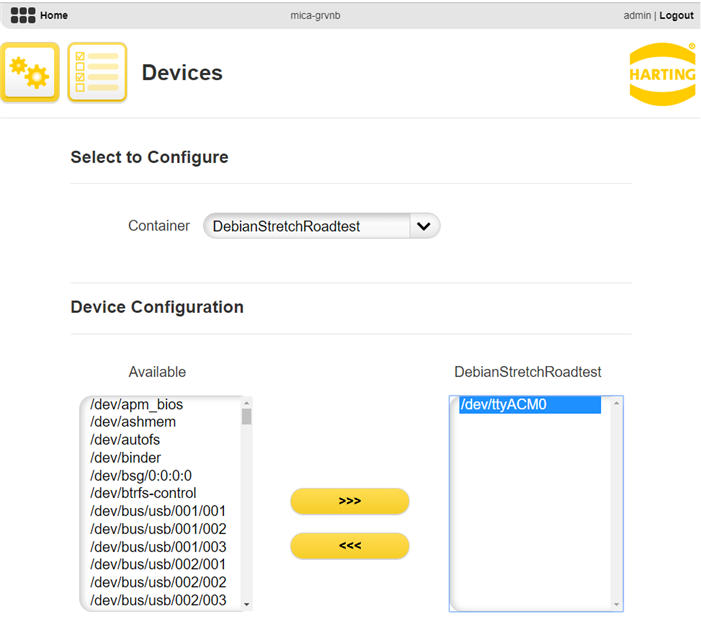

In the MICA web application, there's an management page that allows to select the devices that are assigned to a particular container.

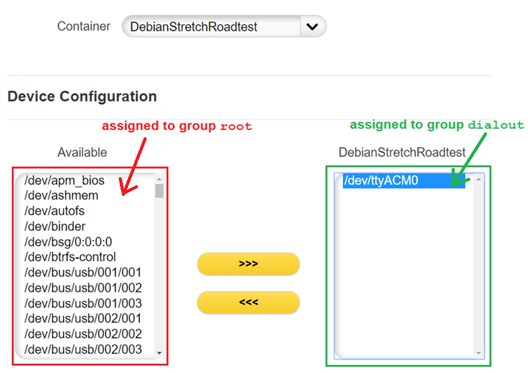

Each container has all available device available in the /dev directory. Even if they aren't selected for that container.
All devices that aren't selected are assigned to the Linux group root.
if you execute the command ls -l /dev , you'll see that all devices are there, whether they are selected in the management app or not.
Here's an example filtered on the BOSCH CISS USB device that comes with the MICA IIoT USB kit. Check the group assignment: root.
If you select that /dev/ttyACM0 device and assign it to your container (see the image in the post intro), and restart the MICA (not only your container!),
the ownership changes to the dialout group.

Summary: the device selection changes the group ownership of selected devices.
Non-selected devices can only be accessed by users belonging to the root group.
Selected devices can be accessed by users belonging to the dialout group - a group that you can safely assign to users without needing root level elevation.
This functionality is useful but requires that you properly set up users and groups in your container.
