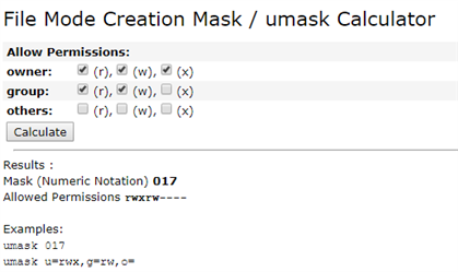

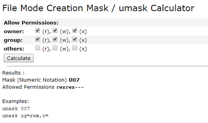

umask 007 and dmask 17 are these responsiblilities:
I wanted to block users from executing files from the sdcard, but they need executable right on directories or they can't access them.
By setting umask=007, files are not executable, except for root. By setting dmask=017, directories are executable and the user can navigate to them.

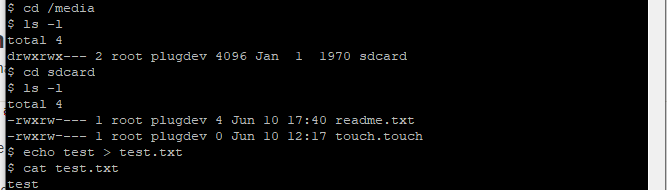

Giving other users access
You do that by adding those users to the plugdev group:
adduser jancumps plugdev
Next time the user account logs in, it can create and write files on the sdcard.

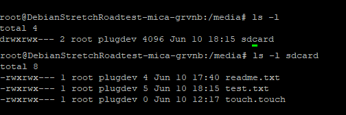

Here's a directory listing and successful write made by my user:
(I edited the picture but this reflects the reality)

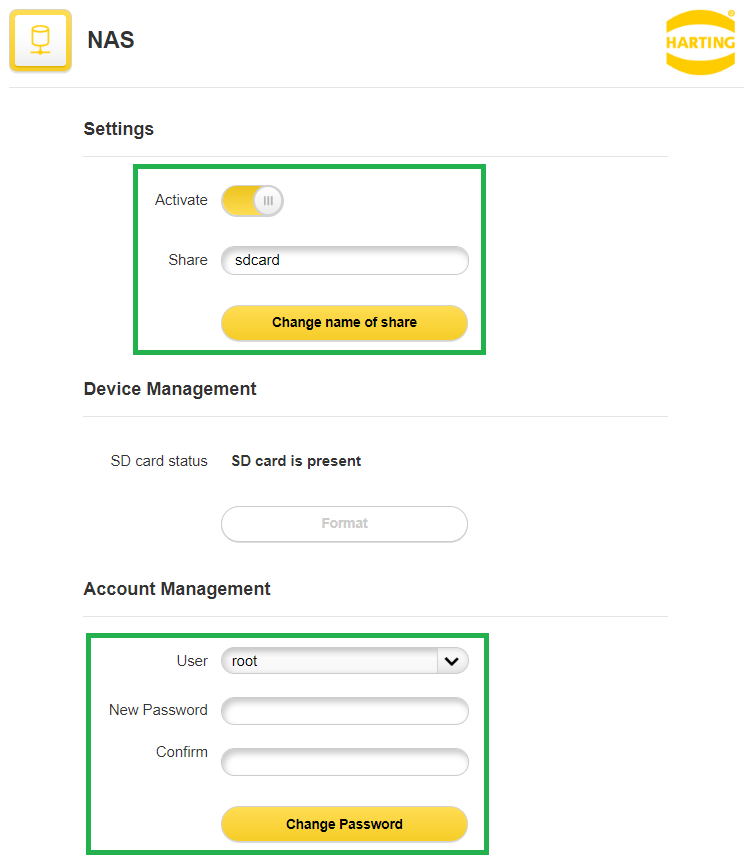

Share the SD card on the Network

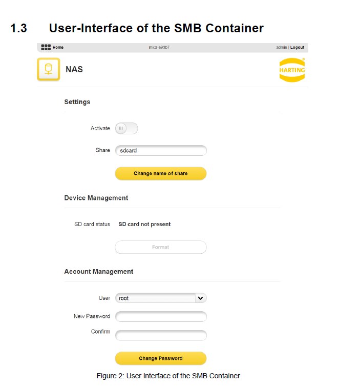

There's a dedicated container to give network access to the SD card. It allows you to publish the SD card as a share.
Configure it similar to this:
The share is now available on the network.
