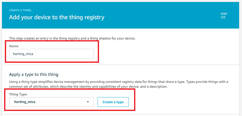

Create a new Thing.
Only the name is mandatory. I created a group, but that - and other settings on this page, are optional.

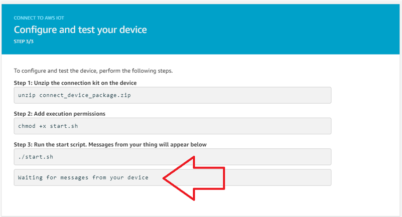

Click on Next the last time, and keepthe window open. Once we have the Mica set up, we can see traffic arriving on this page.
The messages will display where the red arrow is in the image above, once we configured the Mica.

Then execute the list of commands that are listed on the AWS page that you left open from the previous activities.
unzip connect_device_package.zip
chmod +x start.sh
./start.sh
Hooray! Messages arrive.
