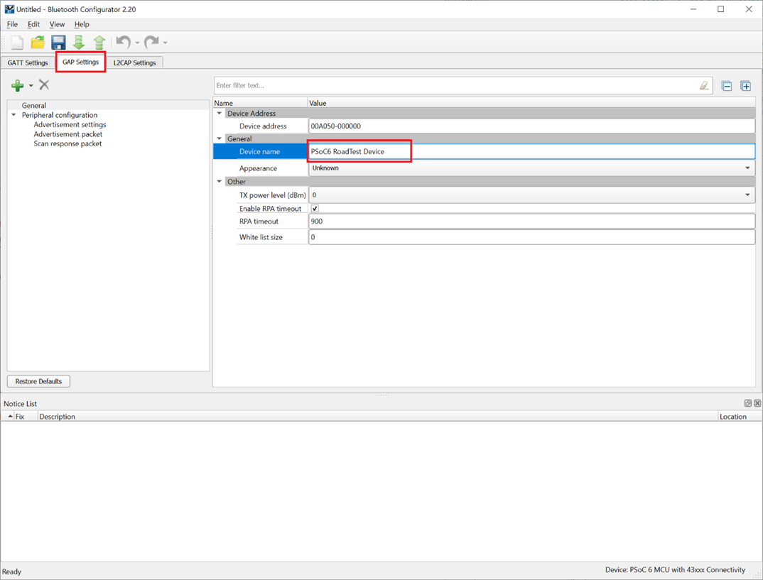

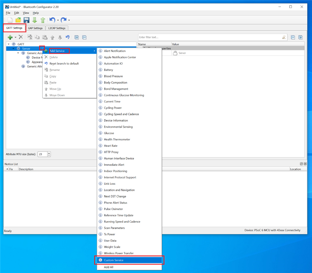

Now open Bluetooth Configuration utility in Quick Launch panel. Switch to GAP Settings tab and change Device name to some name. In controlling application is hardwired “PSoC6 RoadTest Device”. If you change it something else, You will need to modify that app.

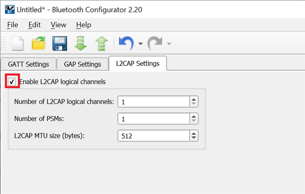

Switch to L2CAP Settings tab and check Enable L2CAP logical channels.

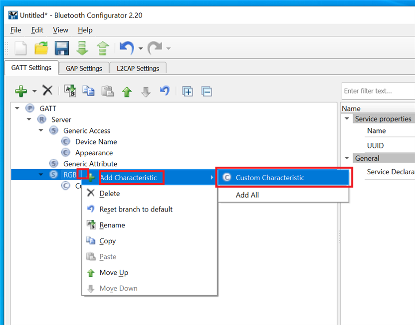

Switch to GATT Settings tab, right click the Server in tree, go Add Service and select Custom Service.
Using F2 key rename new service to RGB. Then Right click the service, select Add Characteristic and Custom Characteristic.

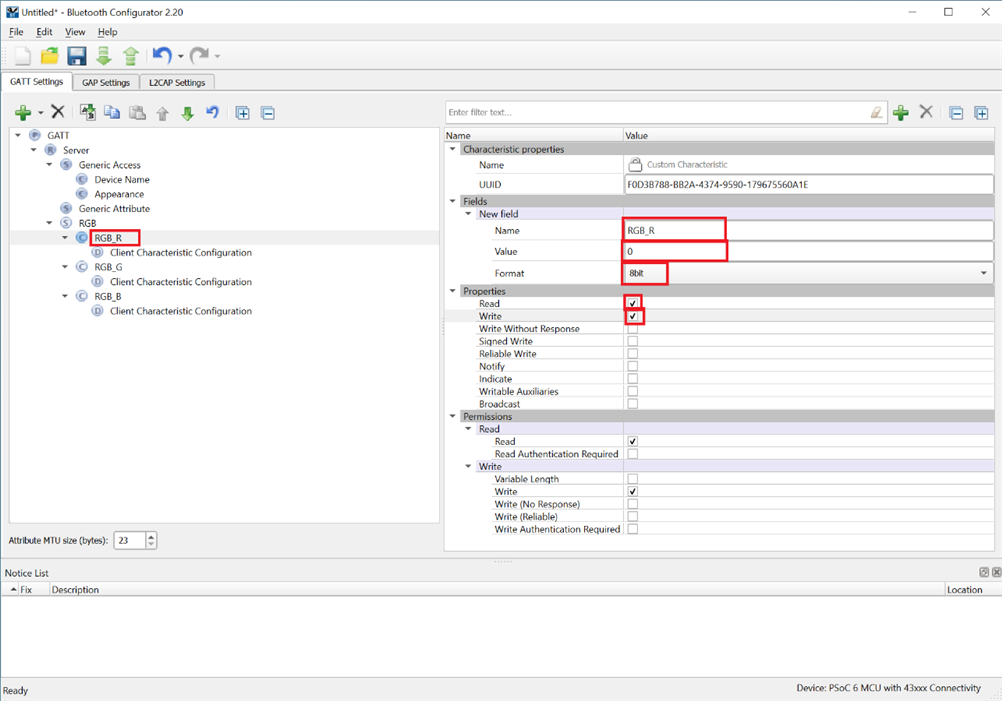

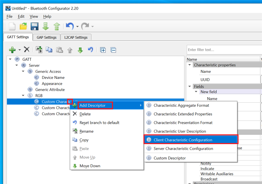

You need three characteristics so add additional one. Then add descriptor using context menu to each characteristic. Use Client Characteristic Configuration.
Using F2 key rename characteristics to RGB_R, RGB_G and RGB_B. Then click each characteristic and in right panel change his name, Format to 8bit and value to 0. Then also assign Read and Write permissions. Do it similarly for all 3 characteristics.
Then Save configuration and close window. This tool generated lot of code for us. We will use it later in our code.

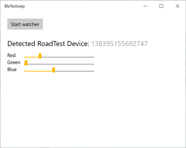

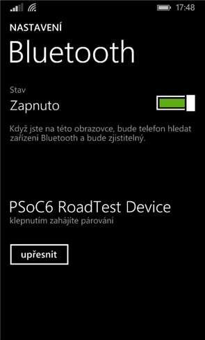

Now that’s all. I prepared Windows 10 application based on Universal Windows Platform (UWP) that you can run on Windows 10 Laptop with Bluetooth module. Description of that app is out of scope this tutorial, but application is available as Visual Studio Solution at the end of article. You can download and run it. Application looks as follows
When you click start watcher, application became listening for discovery messages from devices and then if any message received from device with specific name PSoC6 RoadTest Device, it connect to the device. If connection succeeds, application enables you to set value for R, G and B channels of RGB led. If you have Bluetooth capable device like mobile Phone, you can also check presence of Bluetooth device. You will see the name typed in configuration utility. But I have not created any mobile application to control RGB led using my proprietary protocol (that I designed using utilities at the begining).

That’s all. You can run application. When you connect over Bluetooth and set color using application, you can now regulate brightness of RGB LED using touching and sliding over slider.
