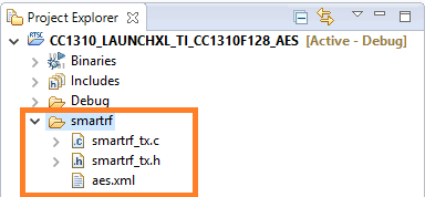

I have a dedicated CCS workspace for the Sender radio (check my blog on how to create a dedicated Sender workspace).
I've created an empty TI-RTOS project for the CC1310 LaunchPad in that workspace.
In that empty project, I've created a new folder called smartrf. A location to hold the radio's configuration and source code.
I let SmartRF create 3 files in that folder.
  • aes.xml - The SmartRF configuration storage file - that one holds all the settings we've made in SmartRF Studio.
    This file is not part of your final firmware, but you'd better safe it so you can recreate your settings in SmartRF Studio later.
  • smartrf_tx.c - the API initialisation and implementation
  • smartrf_tx.h - the API header
I've only created the TX Packet API. When exporting the code, you can choose whether you want TX, RX or both APIs, and if you want continuous or packet mode.
My first program is going to send packets. That's why I've excluded the RX and continuous API parts when generating the files.
In CCS, add the smartrf folder to the include directories (so that the builder finds the .h file).
Do a first compilation. You program should compile without errors, and still behaves as a blinky.
We've once more created a stable situation for ourselves. All code used up until now is tools generated. It's good to validate that nothing is wrong with that before customising it.
In Part 2, We'll add (read: borrow from a TI-RTOS example) our transmitter code.
