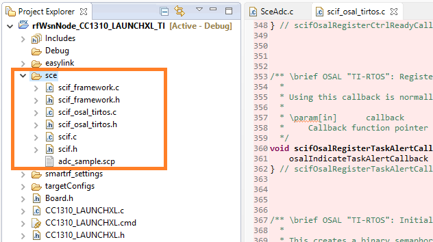

For this blog, where we focus on the Node, we'll just load that example in Code Composer Studio.
Use the Resource Explorer of CCS to load the CC1310 TI-RTOS Driver Examples -> RF Examples -> RF Wireless Sensor Network Node.
This will load project and sources into your IDE, including the Sensor Controller Studio project that we'll use in the next step.

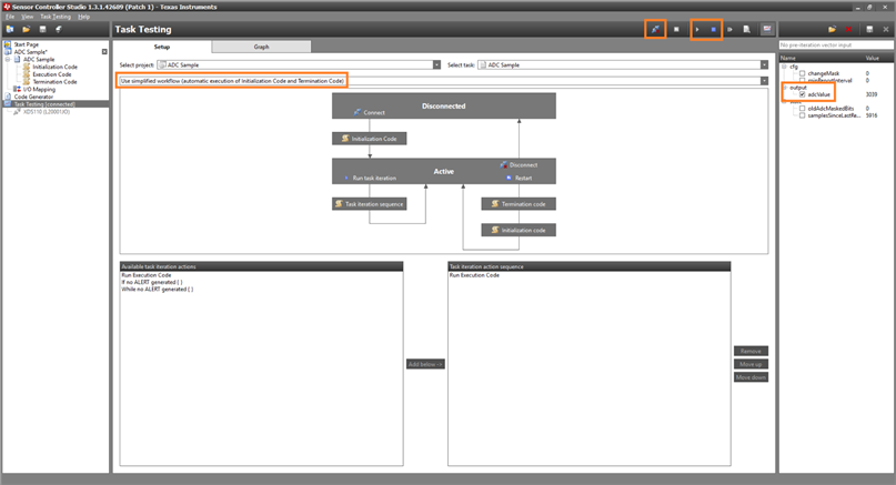

Test the Engine in Isolation from Sensor Controller Studio

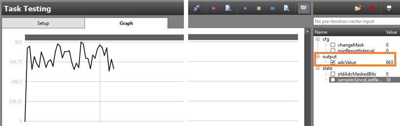

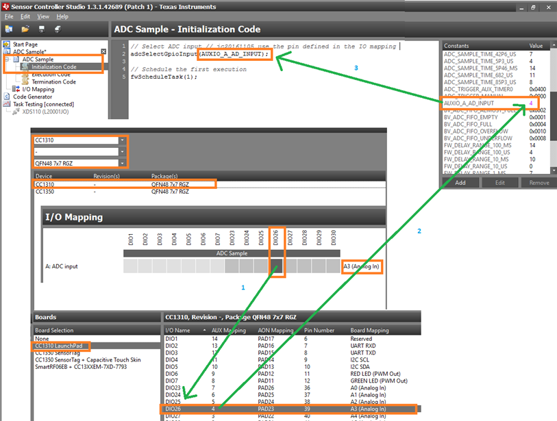

Once you retrieved the project with Resource Explorer, you are ready to run the first test.We'll measure the analog value on analog input DIO26.
The screen capture below shows the studio when our project is loaded (by opening sce/adc_sample.scp).
A warning though. In the example program, the initialisation code ignores the I/O mapping, and passes the fixed value 2 to adcSelectGpioInput().
This is very confusing, because value 2 is pin DIO28 - it took me a while to understand why the example was sampling a different pin as selcted in the I/O.
You fix this by changing the code to adcSelectGpioInput(AUXIO_A_AD_INPUT).
Once that's done, you can start measuring.
I have used a potentiometer. Both ends are connected between GND and +3V3. The middle pin goes to the selected IO, DIO26.

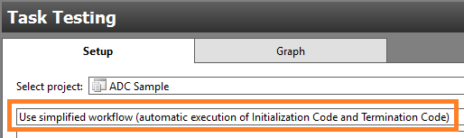

I set the test mode to simplified so that I didn't have to worry about the Init / Termination cycle and started the sampling.
This is te result:

    Jan Cumps over 10 years ago
    I should have added the missing link between project and ADC settings: the task.
    That's the umbrella for an IO management activity in the engine.
    The names of variables and the nature of the activity are defined and managed there.
    In the example, we have one task, AD_INPUT, that manages one analog input. Additionally to that, it's also the location where you define (part of) the constant name AUXIO_A_AD_INPUT that we used.
