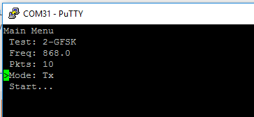

Set up communication as 115200 baud, 8 data bits, 1 stop, no parity, no flow control.
Select the first COM port.
Press the Reset button on top of one of the LaunchPads.
If nothing happens in the Terminal, press the Reset on the other one.
The one that reacts will be your TX device for today.
Click either button 1 or 2 to get a menu
Push button 2 until you are on the Mode line.
Press the left button to go select TX
Now start a second terminal program, and connect to the second serial port.
Push the Reset of the other launchpad. This one will become the receiver.
Press any button to go to the menu. This one is already in receive mode, so we don't have to change that.
Use the button 2 to navigate to Start, and press Button 1 to activate the receiving device.
It's now waiting for traffic.

Return to your first Terminal session. The one where you set the device to TX.
Use button 2 to navigate to Start
Each time you press Button 1, the device will transmit 10 packets.
In the receiver's terminal, you can see the count of received packages increase.
You'll also get an indication of the signal's strength. Keep pushing that button 1 of the transmitter, and the count will keep going up.
