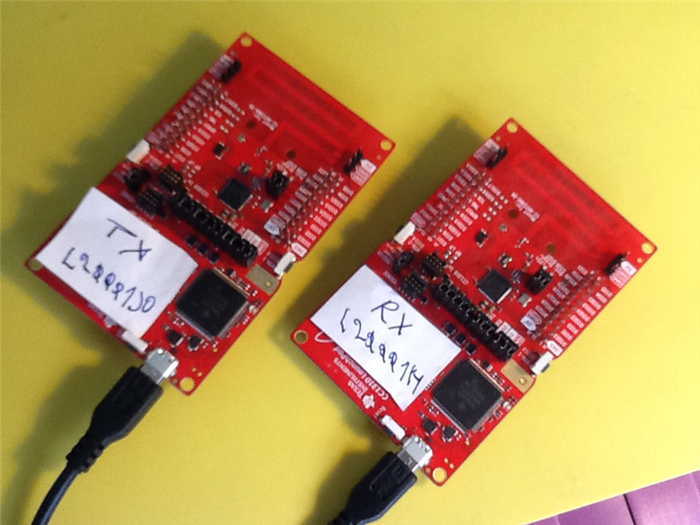

Label one Launchpad as sender and the other as receiver. Just put a label on with the text TX and RX.
From that moment on, you have a visual indicator that tells who is who.

You will get the Serial Num back of your TX Launchpad. Write this code on that label that you just taped on the board.
Unplug TX and plug in the RX board.
Run the xdsdfu /e command again.
You will get a different number. Write that on the RX board.
Our first step is done. You and the computer can identify the individual LaunchPads.

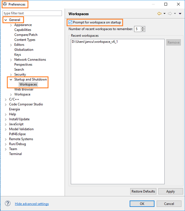

Let's tell CCS it has to prompt for a workspace when starting up:
Window -> Preferences
Confirm your settings and close the dialog and also CCS. You can now start it again, and it will prompt for a workspace.
Create a workspace. I've placed mine in the same folder as the original workspace (your OS home folder) and called it workspace_v6_tx.

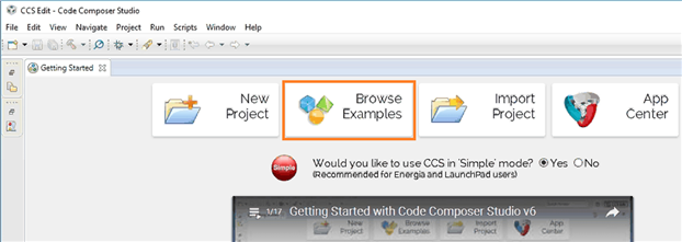

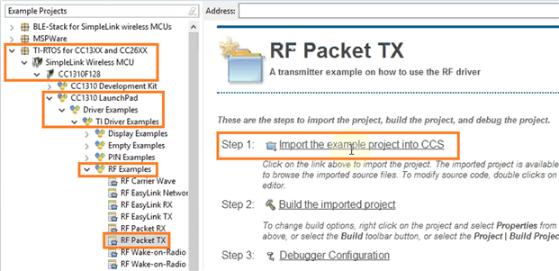

You can immediately load one of the TX examples.
Click on the Browse Examples button on the startup screen (if this doesn't show at startup, open it via View -> Getting started).
Load a TX example.
