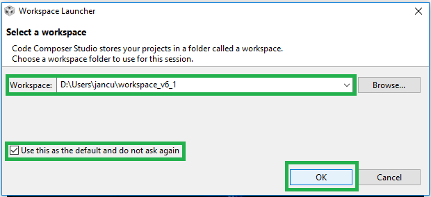

Hey, I want my original CCS behaviour back, and I still want to use a separate session for RX and TX
That's possible.
Restart Code Composer Studio, select your default workspace, and mark the "default" checkbox.
Press OK, and CCS will from now on, by default, open up your generic workspace, as it did originally.
