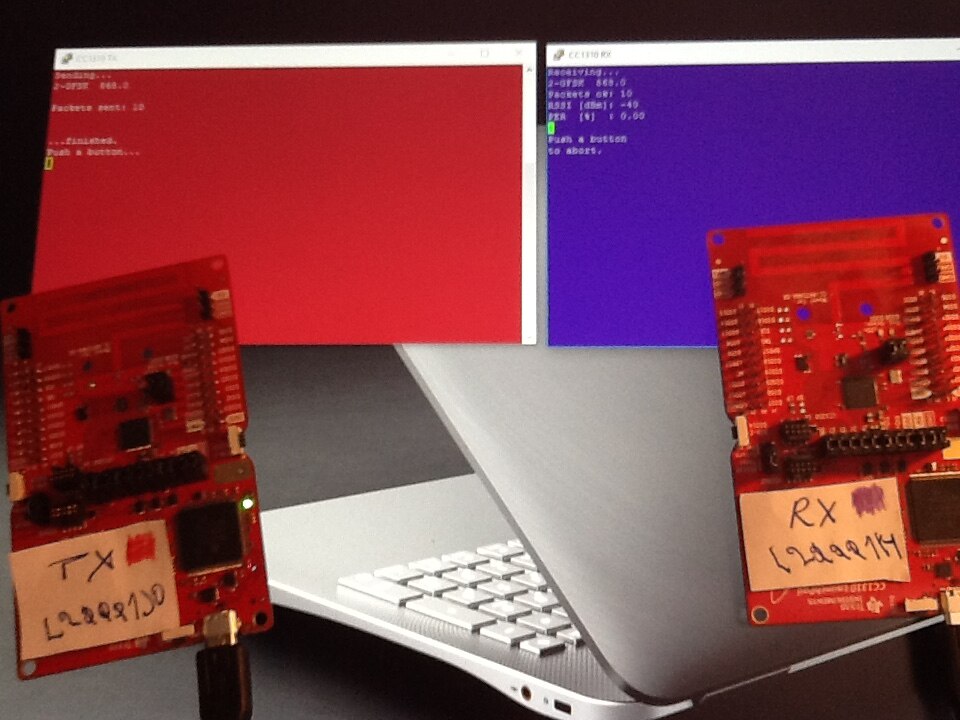

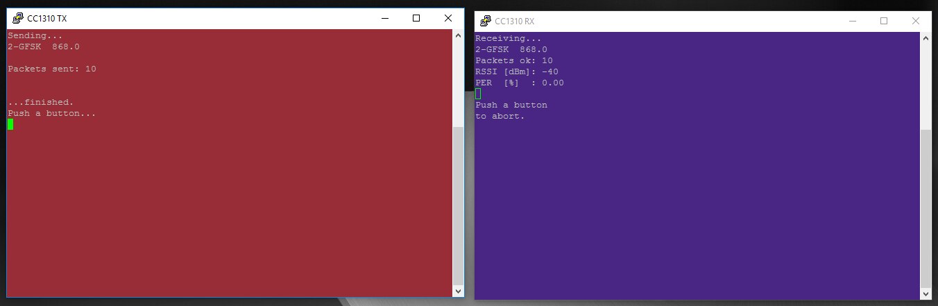

I've configured my PuTTY sessions in a way that its more obvious. The TX one has a red background, the RX one  is purple.
I've also marked the label on my launchpads with the same colour.
The window title is also adapted. It shows TX and RX.

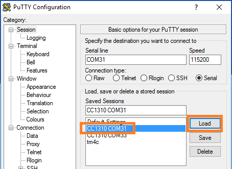

Open your TX puTTY configuration.

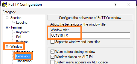

Set the Window Title CC1310 TX

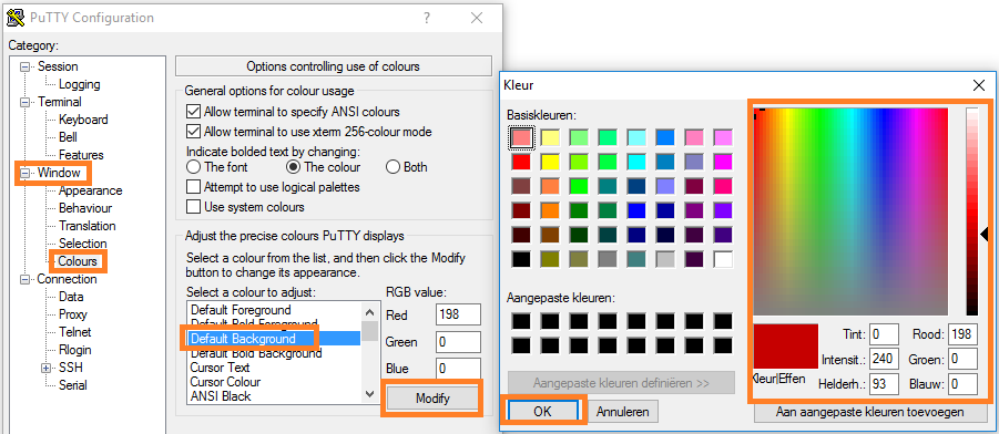

Select a distinct colour. My advice is to use one where you have a matching colour crayon for, so you can also colour the LaunchPad's label image.
Navigate back to Session and Save.
Now load the RX configuration. Choose a different colour and make the title 1310 RX
Save the session. All Done.
Never ever will you have to guess what terminal talks to RX or TX.
