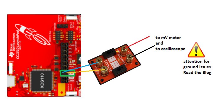

We'll need to measure low currents. And because the 'active' mode is so short, it's best to have a logging mechanism too.
I'm using an EEVblog µCurrent to capture the current and a digital oscilloscope to log the output for later measurements.
µCurrent and voltmeter

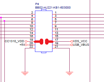

The easiest way to get at the CC1310 current only is at the bridge between debugger and CC1310 part of the LaunchPad.
Remove the 3rd-closest-to-the-side jumper on connector P4, It's labeled 3V3.
We have now cut the power supply to the controller.
Replace the jumper with your µcurrent input.
Place the meter in the µA range.
On the output side of the µCurrent, attach a voltmeter. Put it in the DC mV range if it has that, else in the DC Volt range
Don't attach an oscilloscope yet. If done wrong you'll short your USB power supply.
The µCurrent will output a mV per µA.

The µCurrent isn't an isolated device. You can't just plug your scope probe in the output.
We're going to use a differential measure technique. That allows us to measure the voltage over a component (µCurrent) when both sides of that component aren't at ground level.
Put the hot side of your channel 1 probe on one of the µCurrent outputs, channel 2 probe's hot side on the other µCurrent output.
We'll make sure there's a ground connection between LaunchPad and oscilloscope in the next step, when we're probing the trigger signal.

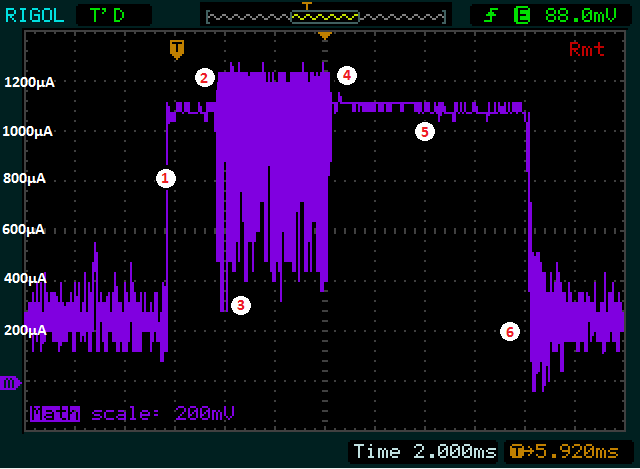

Results
My voltmeter consistently shows close to 270 mV. That indicates that that in low power mode our consumption is close to 270µA.
I can't measure the Active Mode current with the multimeter because the on-time is too short (14-16ms).
That's when the log from our scope is useful.
before 1: Stand-by, 270µA
1 - the ARM core wakes up, 1100µA
T - our trigger line goes high.
2 - the Radio transmits, 1200µA
3 - I don't know the reason why power goes wild at that point. Either the whole device goes into low power mode a few times during transmission, or this is antenna noise.
4 - the Radio listens for the Acknowledgement from the Concentrator, 1150µA
5 - Radio off, ARM Core does bookkeeping and prepares to sleep, 1100µA
6 - Idle, 270µA (and this until the next instance of the wake-up cycle).
For power consumption calculation, multiply with 3.3V and the time taken for each chunk.
If we wake up every minute; and the up-time is roughly 15ms
59.85s      we consume 3.3V * 0.00027A = 0.000891W
0.15s        we consume 3.3V * 0.0012A = 0.00396W
per minute: 0.004851W -> 0.0000809 WH

ModeMeasuredSpecified
Standby270µA1.7µA + 130µA (Timers) (+ maybe UART or µDMA?)
ARM core on1100µA1200µA + frequency and load dependent addition
Radio Transmit1200µA1200µA + approx 20µA + frequency and load dependent addition
Radio Receive1150µA1200µA + 5.5µA + frequency and load dependent addition
With my low-tech measurements, I'm not that far off of the theoretical values.
