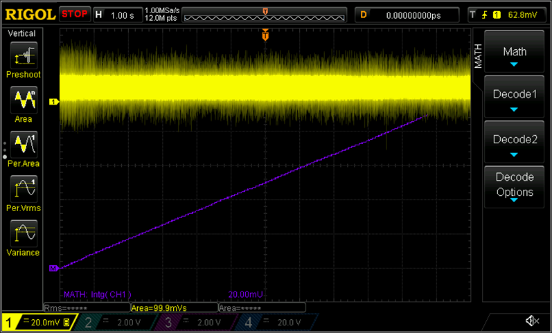

Measure the Consumption
I'm using my oscilloscope's integration function to get the power over a significant time.
I'll redo this exercise whenever I (think I will) make a significant power save step in future posts.
Current is converted by a µCurrent. 1 mV represents 1 mA. Power source is 1.8 V.
The time base is 1 second per division. Total 12 seconds. We capture 23 and a bit loops of the controller.
The A signal is set to 20 mv / division
Math is set to integral of channel A; 20 mUnits / division.
I've also used a measure to calculate the area under A. That should give the same result as the math signal at the end of the X scale.
I've redrawn the integral by hand for clarity (I haven't found a way to give the math channel focus on my scope).
Measure says I consumed 100 mVs. The math function shows just a tad over 5 divisions, 100 mUnits.
This is measured with the device in continuous mode, so the startup power is ignored. That's on purpose.
Now that I know that I've burned 100 mVs, measured over 12 seconds, I have a reference for the optimisation exercise.
Multiply by 1.8 V then divide by a magic number to know the amphours.
disclaimer: I haven't validated this. Maybe my reasoning is off and the measure vs math values seem to match by accident. I'd trust the math's integral value more.
But then I have to look up in the manual what 20 mU means, in relation to the settings of channel A.
If you know, tell me.
