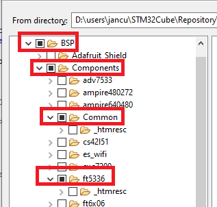

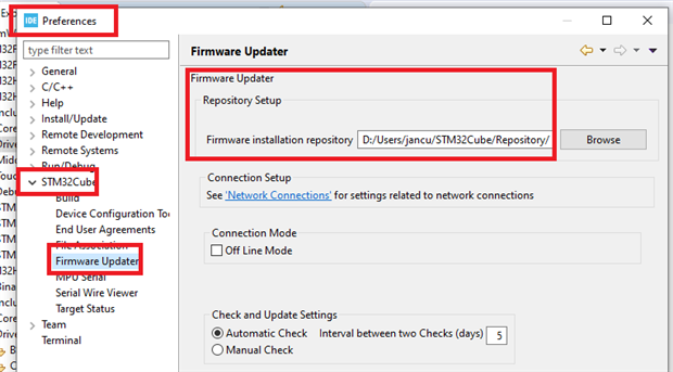

The logic is dependent on the board definition files. We can import them from the firmware support package.
If you don't know where that is installed, check via the IDE  Windows -> Preferences menu

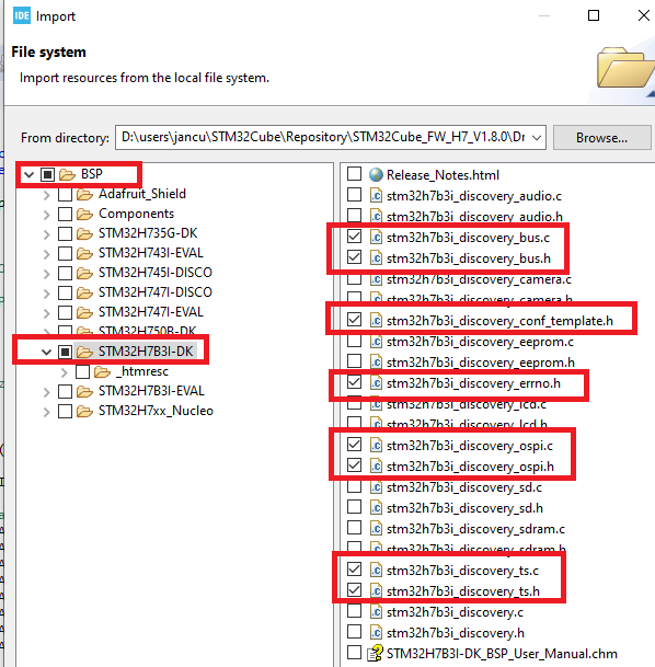

Right-click on the Drivers folder and select Import -> File System
Navigate to where you installed the firmware - In our case, it's version 1.6.0 because that's the one used in the TouchGFX .ioc file. Look for the folder Drivers and select these:
Then select the project's BSP folder, right-click and select Import
Rename Drivers/BSP/STM32H7B3I-DK/stm32h7b3i_discovery_conf_template.h to stm32h7b3i_discovery_conf.h.
Rename Drivers/BSP/Components/mx25lm51245g/mx25lm51245g_conf_template.h to mx25lm51245g_template.h.
Rename Drivers/BSP/Components/ft5336/ft5336_conf_template.h to ft5336_conf.h.

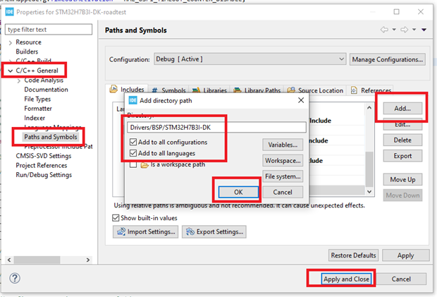

Adapt the include settings, by right-clicking the project, then select properties:
Build and Debug again. The touch screen should now work. It does for me image.
