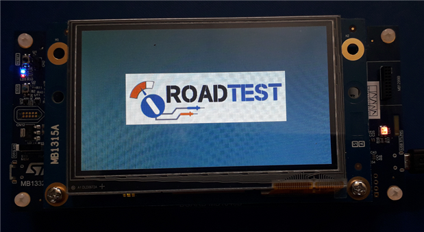

The kit has arrived, and the first results have been mostly successful, except for graphic projects using TouchGFX.
What works for me:
image A graphical STemWin project. I imported the example in CubeIDE, built it, loaded via STLink and debugged it.

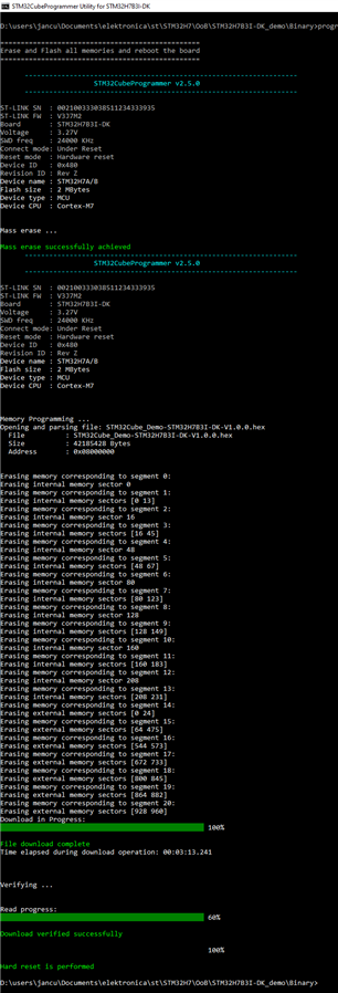

image Out of Box binary downloaded from product page and then upload it via STLink using the STMCube Programmer.
image what I can't get to work yet: Compile a ToughGFX (example import or a self-made project) and load it on the board from CubeIDE.
The compilation / build succeeds. The STLink debug session starts but then the firmware load fails.

    I have it working on the CubeIDE too now. I reused a .ioc file from a TouchGFX generated project for this board, and created a new CubeIDE project based on that. Then used the generated hyperlink to load…
    Jan Cumps over 6 years ago +3
    Yes, got the CubeIDE and debugger integration working with the screen! www.youtube.com/watch
