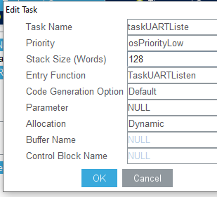

In Tasks and Queues, add a task that will manage our UART:
The task is reviewed later in this post, when we write the content.

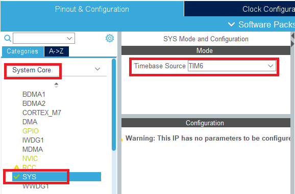

Then we configure timer 6 as the RTOS timer.

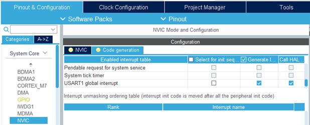

Enabled the global interrupt in the NVIC tab,
In the SYS -> NVIC settings, I then enabled the USART global interrupt in the NVIC tab, Preemption priority 15.
In the Code Generation tab, I checked Generate IRQ handler and Call HAL handler
Then I saved and generated code.

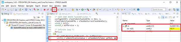

That is it. To test it, check the COM port that's assigned to the USB of the development kit, and configure a serial terminal such as PuTTY or the Eclipse Terminal to 115200, 8, 1 N.
Set a breakpoint on this line
uint32_t ulNotificationValue = ulTaskNotifyTake( pdTRUE, portMAX_DELAY );
When the code reaches that line the first time, it'll stop.
Then use the Step Over function to execute that line only.
The debugger will not stop, because this line only returns if it receives a notification from the interrupt.
Type a character in the terminal, then see the debugger stop.
inspect the value of in[0]. It 'll be the character you typed in the terminal.
Resume the project and type another character, ...
