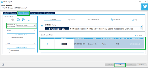

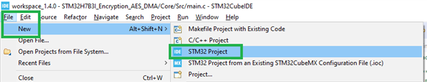

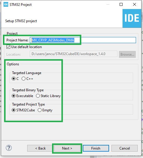

Enough intro, action now. In CubeIDE, start a new STM32 Project
Select either the controller or the board that we're using.
Selecting the board is easiest. Because then the clock settings will be done for us: STM32H7B3I-DK

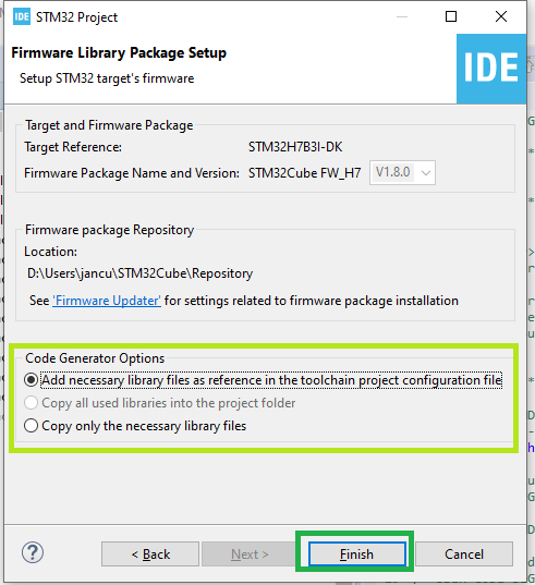

Name the project. It's in C, executable, and STM32Cube style for full MX support.
You can choose your prefered solution here. I use reference because it generates a smaller .zip fil to add to the blog.

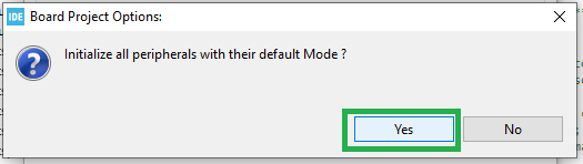

Let the wizard generate defaults for the drivers.
That's it. This generated a fresh project. With latest drivers and MX support.

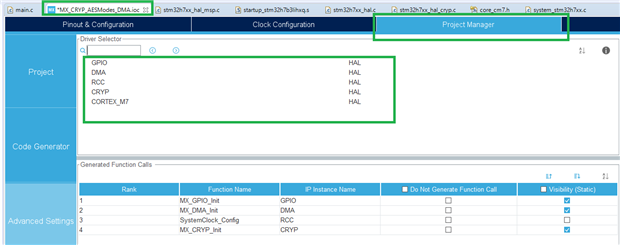

Peripheral and Driver Setup with CubeMX
CubeIDE automatically loads the MX screen when the project is generated. Time to set up the modules.
All setup I show here is exactly mimicking what the original STM32 example does.

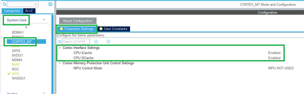

CPU Cache
Enable both ICache and DCache.
Here's the original code from the example. MX will generate compatible code for us.

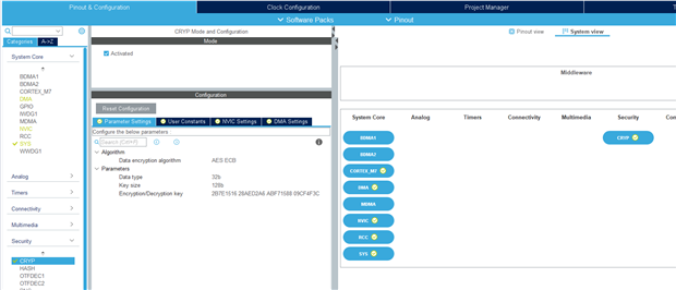

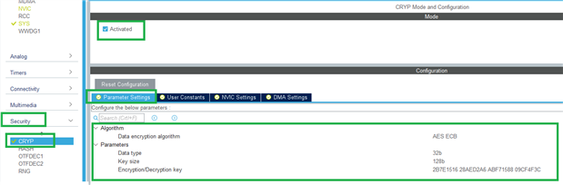

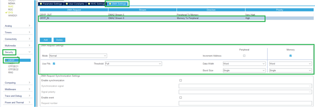

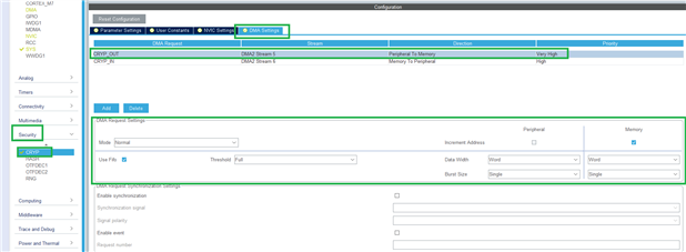

Cryptography Configuration
This is the main focus of the project.
Enable the module and set the attributes as in the picture below.
Check the original code extract at the end of this subsection for reference.
Set method, keys:
The DMA pipelines for reading and writing memory:
Interrupt settings:
Again the original example's code, for comparison:

DMA configuration
Nothing to do here. Our Crypto settings are automatically reflected in the DAM module.
You can click on the module and verify. No changes needed.

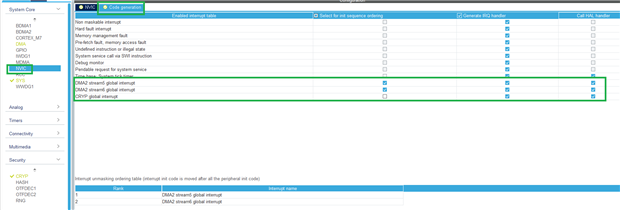

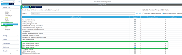

Interrupt Configuration
In this module, the priority and order are set ...
... and you flag what interrupt functions MX should pre-generate.

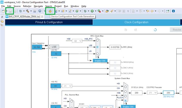

That's it. Save the configuration file and generate the code.

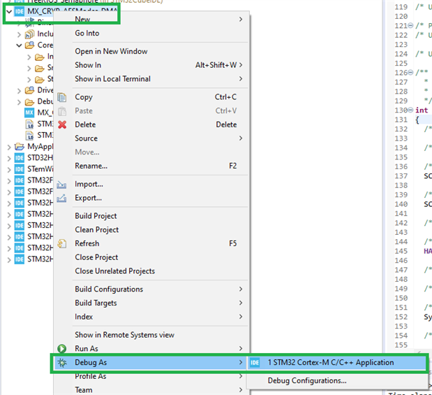

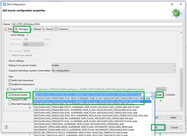

Compile and Run
Set the dedicated load script for this board.
Optimisation
When I opted to let MX generate a project for this board, it configured and enabled a number of peripherals that aren't needed for this project.
I selected those and set them to disabled. In the end, these essential resources were kept active:
If you see more resources in this tab in your project, go to the unneeded resources and disable them.
This does not change the logic. It gives smaller code and less init time. I have not checked if power consumption is affected.
