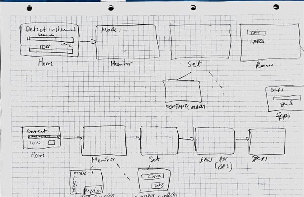

image: proposed GUI flow

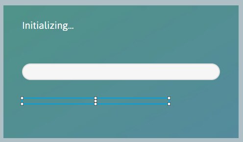

Initial Script: use Timer to Show a Progress Bar and Status while Starting Up
The process I'm mocking here, is checking if the test instrument is connected, then check what mode it is in.
While doing that, display a progress bar. And intermediate statuses.
Then when that's done, move to another screen based on the instrument's mode.
I used ST's Progress Bar tutorial to learn about using background processes and keeping the interface active at the same time.
There are different locations to react to a TouchGFX tick. I want the tick to animate the screen (progress bar) so I used the home screen View's tick.
I told before that this is a mock. Instead of really checking if the electronic load is ready, I faked a few moments when to simulate that the instrument was up, and it reported it's mode:

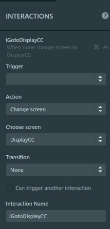

Most of this code is indeed simulation, but there is one new thing I wanted to test: Opening a new screen when the instrument reports ready:
static_cast<FrontendApplication*>(Application::getInstance())->gotoDisplayCCScreenNoTransition();
This is the mechanism to make the LCD switch another display.
The gotoDisplayCCScreenNoTransition() method is generated by the TouchGFX Designer.

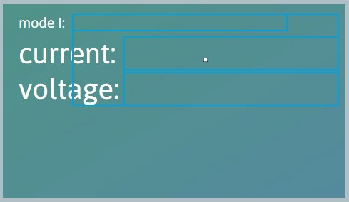

When I created the second screen, called DisplayCC, I defined the handler for its display, by generating an interaction.
No matter in what screen yo define that interaction, the functions generted will end up in FrontendApplicationBase.cpp:
// DisplayCC
void FrontendApplicationBase::gotoDisplayCCScreenNoTransition() {
    transitionCallback = touchgfx::Callback<FrontendApplicationBase>(this, &FrontendApplication::gotoDisplayCCScreenNoTransitionImpl);
    pendingScreenTransitionCallback = &transitionCallback;
void FrontendApplicationBase::gotoDisplayCCScreenNoTransitionImpl() {
    touchgfx::makeTransition<DisplayCCView, DisplayCCPresenter, touchgfx::NoTransition, Model >(&currentScreen, &currentPresenter, frontendHeap, &currentTransition, &model);
Calling the first function from the TouchGFX Application API is all that's needed to switch screens.
The second screen is very simple too. Again a mock:
Then - just to check the look and feel, I animate the two mock measured values:
void DisplayCCView::handleTickEvent() {
  static float iCurr = 0.998;
  static float iVolt = 3.898;
  static uint16_t count = 0;
  if ((count % 50) == 15) {
    iCurr = 0.997;
    iVolt = 3.898;
  if ((count % 50) == 40) {
    iCurr = 0.998;
    iVolt = 3.899;
  count++;
  Unicode::snprintfFloat(txtCurrentValBuffer, TXTCURRENTVAL_SIZE, "%3.3f A", iCurr);
  Unicode::snprintfFloat(txtVoltageValBuffer, TXTVOLTAGEVAL_SIZE, "%3.3f V", iVolt);
  txtCurrentVal.invalidate();
  txtVoltageVal.invalidate();
image source: the mockup running on the road test kit
