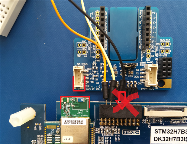

I'll start with a rant. The fan-out expansion board does not fit. It is not possible that STMicroelectronics have tested it.
The i2c Grove connector blocks against the WiFi module. It is not physically possible to plug them together.
I'll desolder the i2c connector. But what a shame. Even with he connector off, the fan-out will interfere with the WiFi antenna because it's in the keep-out region.

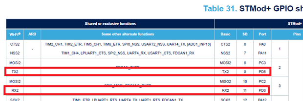

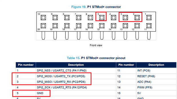

Back to business. I want to use the UART2 of the controller. And that's broken out to that STMod+ connector.

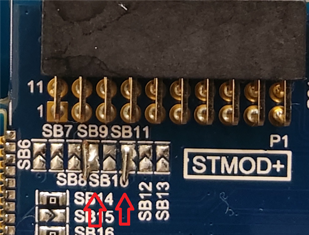

There are multiple options for the pins 2 and 3. To take care that they are connected to the controller UART2 pads, you connect 2 solder bridges:
SB9 for TX, SB11 for RX.
This is not hard. I used a little single wire chunk. The better way is to use a 0R resistor. You can also try to just bridge the pads with solder.

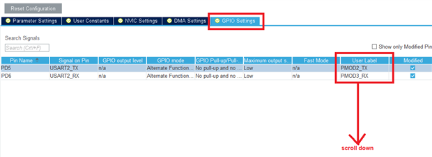

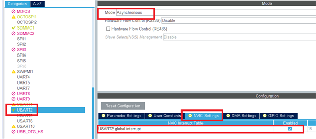

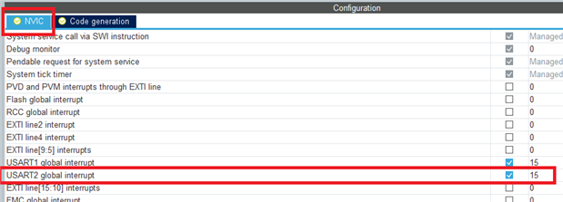

Let's enable UART2.
For documentation reasons, I gave the 2 pins a user name.

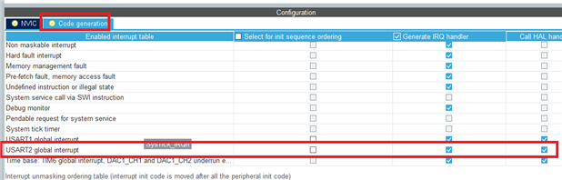

Adapt the interrupts in the NVIC properties:
And enable code generation (as we did in the previous post for UART1)
Generate the code.

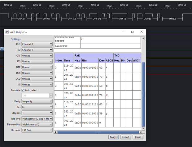

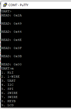

Both Tx and Rx work. I've tested both directions.
I use a Bus Pirate to emulate the other side of the communication (it's an excellent protocol test tool), and a Papilio Pro FPGA as logic analyser:
