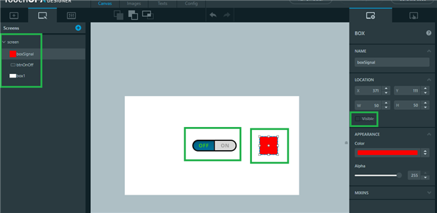

Create a Screen
First the background. Start with putting a Box shape on the empty screen. Same size as the screen. White.
(you can also use another colour - or no box, but I leave it up to you to see what happens if you provide no background)
Then put a toggle button and another - red -  box on the screen.
Name the button btnOnOff (not critical), name the box boxSignal (critical, because we'll use it in our code).
Then, make the box invisible, so that it doesn't show at startup. We'll make it appear in the code.

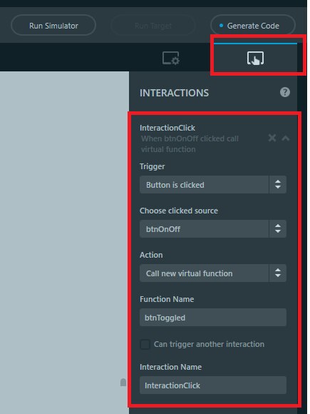

In Designer, you select the interactions tab.
Take care to use the exact same settings as above and use the same Function name.

In the CubeIDE, navigate to the screen class. We'll add the virtual handler that we asked for in Designer.
First add the virtual event handler to your screen class: TouchGFX/gui/include/gui/screen_screen/screenView.hpp.
class screenView : public screenViewBase
public:
    screenView();
    virtual ~screenView() {}
    virtual void setupScreen();
    virtual void tearDownScreen();
    virtual void btnToggled();
